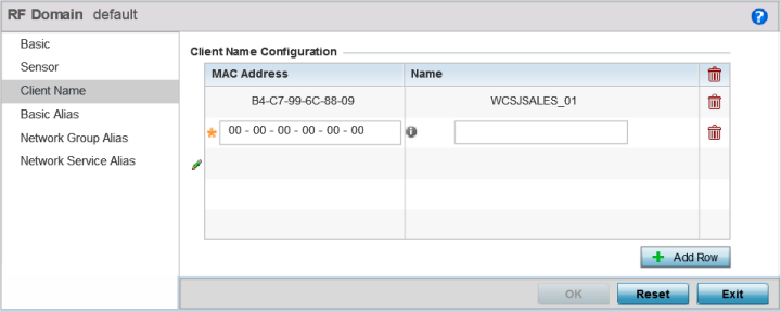

The RF Domain Client Name Configuration screen displays clients connected to RF Domain member access points adopted by networked controllers or service platforms. Use the screen to associate administrator assigned client names to specific connected client MAC addresses for improved client management.
To define a client name configuration used with RF Domain member devices:
Procedure
  1. Go to Configuration → Devices.
  2. Select an RF Domain from those listed on left-hand side of the UI.
    The RF Domain configuration menu displays in the left-hand UI.
  3. Select Client Name.
    The Client Name Configuration screen displays.
    RF Domain - Client Name Configuration Screen
  4. Either select the + Add Row button to create a new client configuration or highlight an existing configuration and select the Delete icon to remove it.
  5. Enter the client‘s factory coded MAC Address.
  6. Assign a Name to the RF Domain member access point‘s connected client to assist in its easy recognition.
  7. Click OK to save the changes to the configuration.
