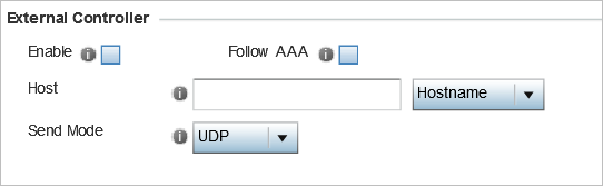

  4. Refer to the External Controller section in the WLAN Policy security screen.
    WLAN Policy Security Screen - External Controller Field
  5. Select the Enable option if WLAN authentication is to be handled using an external resource.
  6. Use the Host field to enter a hostnameor IP address of the remote wireless controller.
    Use the spinner control to select the type of the remote controller.
  7. Use the Proxy Mode drop-down to configure the proxy mode for accessing remote resources.
  8. Select OK when completed to update the WLAN's external controller configuration.
    Select Reset to revert to the last saved configuration.
