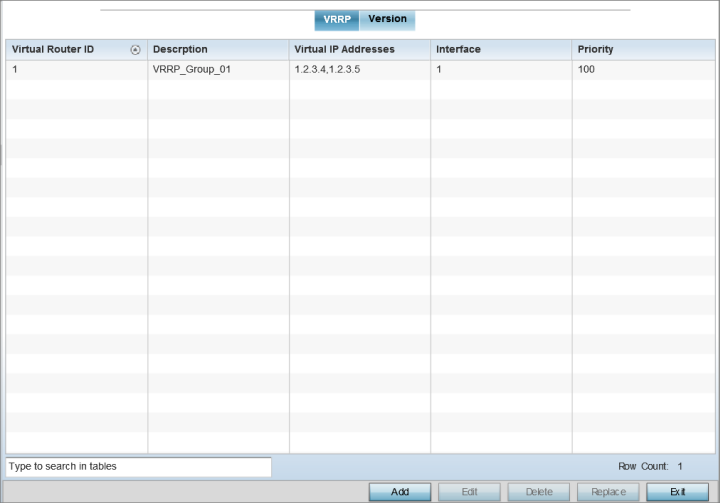

  1. Select the Configuration → Devices → System Profile → VRRP tab from the web UI.
    Profiles - VRRP screen - VRRP tab
  2. Review the following VRRP configuration data to assess whether a new VRRP configuration is required or whether an existing VRRP configuration can be modified or removed:
    Virtual Router ID A numerical index (from 1 - 255) used to differentiate VRRP configurations. The index is assigned when a VRRP configuration is initially defined. This ID identifies the virtual router for which a packet is reporting status.
    Description A description assigned to the VRRP configuration when it was either created or modified. The description is implemented to provide additional differentiation beyond the numerical virtual router ID.
    Virtual IP Addresses The virtual interface IP address used as the redundant gateway address for the virtual route.
    Interface The interfaces selected on the access point to supply VRRP redundancy failover support.
    Priority A numerical value (from 1 - 254) used for the virtual router master election process. The higher the numerical value, the higher the priority in the election process.
