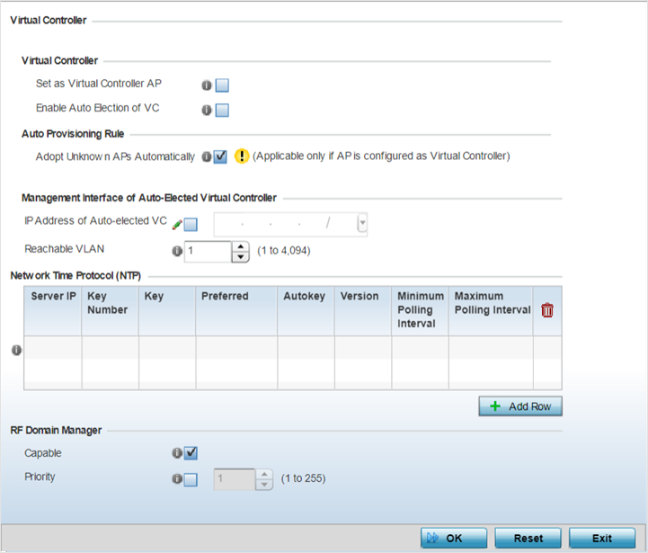

    General Profile Screen
  3. Select the Set as Virtual Controller AP checkbox, to configure this AP as VC.
  4. Select the Enable Auto Election of VC checkbox to enable AP as a Dynamic Virtual Controller (DVC). DVC enables/disables auto-selection of AP as VC.
    When enabled, the AP on being elected as the RF Domain manager takes on the role of the virtual controller. In an RF-Domain, DVC can be enabled on multiple access points. However, only the current RF-Domain manager AP has a running instance of the DVC. This option is applicable only if enabling DVC.
    If you have enabled DVC on RF Domain APs, configure management interface details.
    MLCP discovery does not function on APs enabled as VC or DVCs. Do an explicit “mint link vlan X” on the AP‘s device/profile context, or “control-vlan X” in the AP‘s RF-Domain context, to establish MiNT links between the VC and its adopted APs.
    DVC is not supported on the new 802.11ax APs.
  5. If you set the AP is a VC, select the Adopt Unknown APs Automatically checkbox.
  6. If enabling DVC, use this option to configure the Management Interface of Auto-Elected Virtual Controller. Configuring the management interface ensures failover in case the RF Domain manager is unreachable.
    IP Address of Auto-elected VC Select the checkbox and enter the management interface IP address.
    Due to the random nature of DVC, specifying an explicit management interface IP address makes it easier to manage VCs. In case of fail over, this IP address is installed as the secondary IP address on the new VC.
    Reachable VLAN Specify the VLAN from 1 - 4094 on which the management interface IP address is configured.
    For DVC, configuring management-interface ip address is mandatory. However, VLAN configuration is optional. If you configure the ip address without specifying the VLAN, the system configures the specified ip address as secondary ip on VLAN 1.

  8. Use the RF Domain Manager field to configure how this access point behaves in standalone mode. Set the following parameters:
    Capable Select to enable this access point to act as a RF Domain Manager in a particular RF Domain.
    Priority Select to prioritize this access point in becoming a RF Domain Manager in its; particular RF Domain. The higher the value, the more likely the device becomes the RF Domain Manager for the domain.
  9. Select OK to save the changes made to the general profile configuration.
