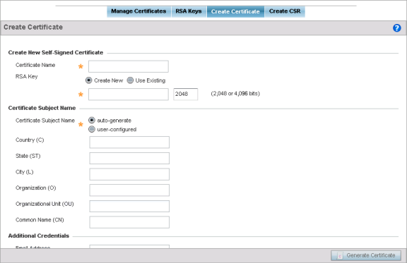

    The Certificate Management screen displays, with the Manage Certificates tab selected by default. This screen displays all existing trustpoints.
  2. Select the Create Certificate tab.
    The Create Certificate screen displays.
    Create Certificate Window
  3. Set the following Create New Self-Signed Certificate configuration parameters:

  6. Select the Generate Certificate button at the bottom of the screen to generate the certificate.
