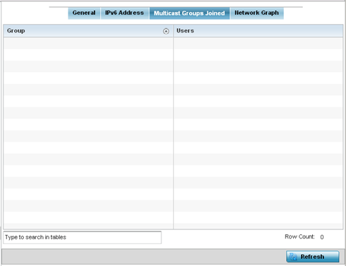

To view the Access Point‘s multicast group memberships on the selected interface:
Procedure
  1. Select the Statistics menu from the Web UI.
  2. Expand the System node from the navigation pane (on the left-hand side of the screen).
    The System node expands to display the RF Domains created within the managed network.
  3. Expand an RF Domain node, and select one of it's connected access points.
    The Access Point's statistics menu displays in the right-hand side of the screen, with the Health tab selected by default.
  4. Expand the Interfaces menu.
  5. Select the Multicast Groups Joined tab.
    The Statistics > AP > Interfaces > Multicast Groups Joined displays in the right-hand pane.
    This table displays the following information:
    Group Lists the name of existing multicast groups whose current members share multicast packets with one another on this selected interface as a means of collective interoperation.
    Users Lists the number of devices currently interoperating on this interface in each listed multicast group. Any single device can be a member of more then one group at a time.
