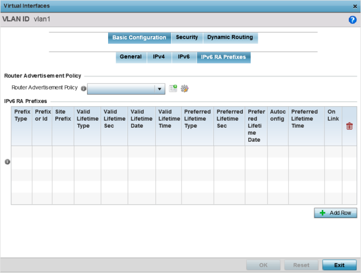

To configure the VLAN IPv6 RA Prefixes configuration:
Procedure
  1. Select the IPv6 RA Prefixes tab.
    Profile Overrides - Virtual Interfaces Basic Configuration Screen - IPv6 RA Prefixes Tab
  2. Use the Router Advertisement Policy drop-down menu to select and apply a policy to the virtual interface.
    Router advertisements are periodically sent to hosts or sent in response to solicitation requests. The advertisement includes IPv6 prefixes and other subnet and host information.
  3. Review the configurations of existing IPv6 advertisement policies.
    If necessary, select + Add Row to define the configuration for an additional IPv6 RA prefix.

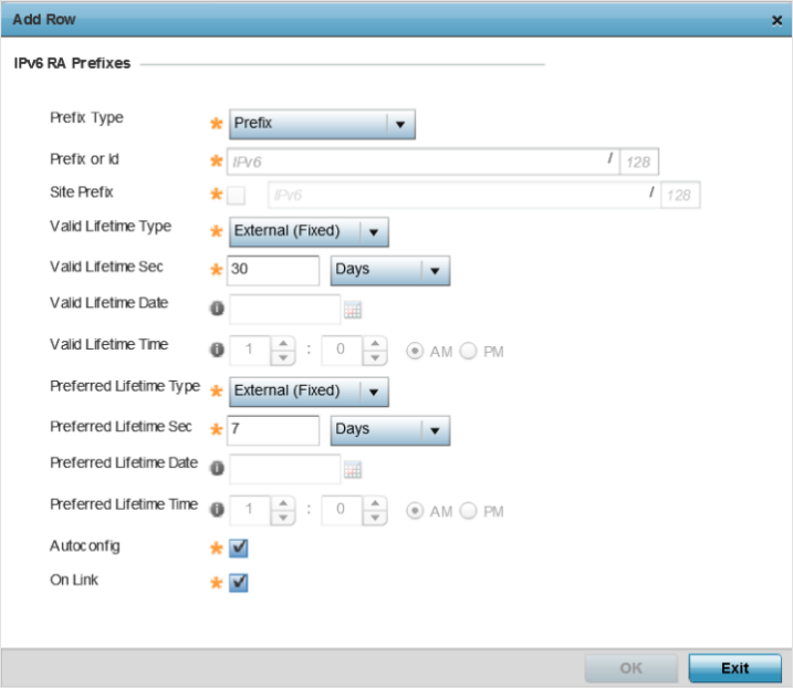

  4. Define the following IPv6 RA Prefix settings:
    Prefix Type
    Set the prefix delegation type used with this configuration. Options include Prefix, and prefix-from-provider. The default setting is Prefix. A prefix allows an administrator to associate a user defined name to an IPv6 prefix. A provider assigned prefix is made available from an ISP (Internet Service Provider) to automate the process of providing and informing the prefixes used.
    Prefix or ID
    Set the actual prefix or ID used with the IPv6 router advertisement.
    Site Prefix
    The site prefix is added into a router advertisement prefix. The site address prefix signifies the address is only on the local link.
    Valid Lifetime Type
    Set the lifetime for the prefix's validity. Options include External (fixed), decrementing, and infinite. If set to External (fixed), only the Valid Lifetime Sec setting is enabled to define the exact time interval for prefix validity. If set to decrementing,, use the lifetime date and time settings to refine the prefix expiry period. If set to infinite, no additional date or time settings are required for the prefix and the prefix will not expire. The default setting is External (fixed).
    Valid Lifetime Sec
    If the lifetime type is set to External (fixed), set the Seconds, Minutes, Hours, or Days values used to measure the prefix's expiration. 30 days, 0 hours, 0 minutes, and 0 seconds is the default lifetime.
    Valid Lifetime Date
    If the lifetime type is set to External (fixed), set the date in MM/DD/YYYY format for the expiration of the prefix.
    Valid Lifetime Time
    If the lifetime type is set to decrementing, set the time for the prefix's validity. Use the spinner controls to set the time in hours and minutes. Use the AM and PM radio buttons to set the appropriate hour.
    Preferred Lifetime Type
    Set the administrator preferred lifetime for the prefix's validity. Options include External (fixed), decrementing, and infinite. If set to External (fixed), only the Preferred Lifetime Sec setting is enabled to define the exact time interval for prefix validity. If set to decrementing,, use the lifetime date and time settings to refine the prefix expiry period. If set to infinite, no additional date or time settings are required for the prefix and the prefix will not expire. The default setting is External (fixed).
    If the administrator preferred lifetime type is set to External (fixed), set the Seconds, Minutes, Hours, or Days values used to measure the prefix's expiration. 30 days, 0 hours, 0 minutes, and 0 seconds is the default lifetime.
    Preferred Lifetime Date
    If the administrator preferred lifetime type is set to External (fixed), set the date in MM/DD/YYYY format for the expiration of the prefix.
    Preferred Lifetime Time
    If the administrator preferred lifetime type is set to decrementing, set the time for the prefix's validity. Use the spinner controls to set the time in hours and minutes. Use the AM and PM radio buttons to set the appropriate hour.
    Autoconfig
    Autoconfiguration includes generating a link-local address, global addresses via stateless address autoconfiguration and duplicate address detection to verify the uniqueness of the addresses on a link. This setting is enabled by default.
    On Link
    Select this option to keep the IPv6 RA prefix on the local link. The default setting is enabled.
  5. Click OK to save the changes to the IPv6 RA prefix configuration.
    Click Exit to close the screen without saving any updates. Or, click Reset to revert to the last saved configuration.
