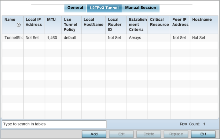

  1. Select the L2TPv3 Tunnel tab.
    The L2TPv3 main screen displays. This screen lists existing L2TPv3 tunnel configurations.
    L2TPv3 Tunnel Main Screen
  2. Review the following L2TPv3 Tunnel configuration data:
    Name
    Displays the name of each listed L2TPv3 tunnel assigned upon creation.
    Local IP Address
    Lists the IP address assigned as the local tunnel end point address, not the interface IP address. This IP is used as the tunnel source IP address. If this parameter is not specified, the source IP address is chosen automatically based on the tunnel peer IP address.
    MTU
    Displays the MTU size for each listed tunnel. The MTU is the size (in bytes) of the largest protocol data unit that the layer can pass between tunnel peers.
    Use Tunnel Policy
    Lists the L2TPv3 tunnel policy assigned to each listed tunnel.
    Local Hostname
    Lists the tunnel specific hostname used by each listed tunnel. This is the hostname advertised in tunnel establishment messages.
    Local Router ID
    Specifies the router ID sent in the tunnel establishment messages.
    Establishment Criteria
    Specifies tunnel criteria between two peers.
    Critical Resource
    Specifies the critical resource that should exist for a tunnel between two peers to be created and maintained. Critical resources are device IP addresses or interface destinations interpreted as critical to the health of the network. The critical resource feature allows for the continuous monitoring of these defined addresses. A critical resource, if not available, can result in the network suffering performance degradation.
    Peer IP Address
    Lists the IP address of the remote peer.
    Host Name
    Lists the tunnel specific hostname used by the remote peer.
