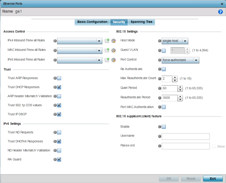

  1. Select the Security tab.
    The security screen displays.
    Profile Overrides - Interface - Ethernet Ports - Security
  2. Refer to the Access Control field. As part of the Ethernet port‘s security configuration, Inbound IP and MAC address firewall rules are required.
    MAC Inbound Firewall Rules Use the drop-down menu to select the MAC inbound firewall rules to apply to this profile‘s Ethernet port configuration. The firewall inspects MAC traffic flows and detects attacks typically not visible to traditional wired firewall appliances.
    IPv4 Inbound Firewall Rules Use the drop-down menu to select the IPv4 specific firewall rules to apply to this profile‘s Ethernet port configuration. IPv4 is a connectionless protocol for packet switched networking. IPv4 operates as a best effort delivery method, as it does not guarantee delivery, and does not ensure proper sequencing or duplicate delivery (unlike (TCP). IPv4 hosts can use link local addressing to provide local connectivity.
    IPv6 Inbound Firewall Rules Use the drop-down menu to select the IPv6 specific firewall rules to apply to this profile‘s Ethernet port configuration. IPv6 is the latest revision of the Internet Protocol designed to replace IPv4. IPV6 provides enhanced identification and location information for computers on networks routing traffic across the Internet. IPv6 addresses are composed of eight groups of four hexadecimal digits separated by colons.
  3. Refer to the Trust field to define or override the following:
    Trust ARP Responses Select this option to enable ARP trust on this port. ARP packets received on this port are considered trusted, and the information from these packets is used to identify rogue devices within the network. This option is disabled by default.
    Trust DHCP Responses Select this option to enable DHCP trust on this port. If enabled, only DHCP responses are trusted and forwarded on this port, and a DHCP server can be connected only to a DHCP trusted port. This option is enabled by default.
    ARP header Mismatch Validation Select this option to enable a mismatch check for the source MAC in both the ARP and Ethernet header. This option is disabled by default.
    Trust 802.1p COS values Select this option to enable 802.1p COS values on this port. This option is enabled by default.
    Trust IP DSCP Select this option to enable IP DSCP values on this port. This option is enabled by default.
    Some vendor solutions with VRRP enabled send ARP packets with Ethernet SMAC as a physical MAC and inner ARP SMAC as VRRP MAC. If this configuration is enabled, a packet is allowed, even when a conflict exists.
  4. Set the following IPv6 Settings:
    Trust ND Requests Select this option to enable the trust of neighbor discovery requests required on an IPv6 network on this Ethernet port. This option is disabled by default.
    Trust DHCPv6 Responses Select this option to trust all DHCPv6 responses on this Ethernet port. DHCPv6 is a networking protocol for configuring IPv6 hosts with IP addresses, IP prefixes, or other configuration attributes required on an IPv6 network. This option is enabled by default.
    ND Header Mismatch Validation Select this option to enable a mismatch check for the source MAC within the ND header and Link Layer Option. This option is disabled by default.
    RA Guard Select this option to enable router advertisements or ICMPv6 redirects from this Ethernet port. This option is enabled by default.
  5. Set the following 802.1X Settings:
    Host Mode Set the port mode for 802.1X authentication. The options are:
    • single-host - Select to bridge traffic from a single authenticated host.
    • multi-host - Select to bridge traffic from any host to this port. The default setting is single-host.
    Guest VLAN Specify a guest VLAN for this port from 1 - 4094. This is the VLAN traffic is bridged on if this port is unauthorized and the guest VLAN is globally enabled.
    Port Control Set the way in which the port bridges traffic. The options are:
    • Automatic – The port is set to the state as received from the authentication server.
    • force-authorized – Any traffic on the port is considered authenticated and is bridged as configured. This the default setting.
    • force-unauthorized – Any traffic on the port is considered unauthenticated and is not bridged.
    Reauthenticate Select this option to enable or disable reauthentication. Reauthentication is primarily used to refresh the current state of the selected port. When enabled the device is forced to reauthenticate. When this happens, the port is still considered authenticated. If reauthentication fails, the port is considered unauthorized and devices using the port are denied access.
    Max Reauthenticate Count Set the number of reauthentication attempts (1-10) when a port tries to reauthenticate and fails. Once this count exceeds, the port is considered unauthorized. The default setting is 2.
    Quiet Period Set the duration in seconds where no attempt is made to reauthenticate a controlled port. Set a value from 0 - 65535 seconds. The default setting is 60 seconds.
    Reauthenticate Period Set the duration after which a controlled port is forced to reauthenticate. Set a value from 0 - 65535 seconds. The default setting is 3600 seconds.
    Port MAC Authentication Enables MAC address authentication on the selected port. When enabled, a port‘s MAC address is authenticated, as only one MAC address is supported per wired port. When successfully authenticated, packets from the source are processed. Packets from all other sources are dropped. Port MAC authentication is supported on WiNG devices. Port MAC authentication may be enabled on ports in conjunction with Wired 802.1x settings for a MAC Authentication AAA policy. This option is disabled by default.
  6. Set the following 802.1X supplicant (client) feature:
    Enable Select to enable 802.1X port-based authentication of 802.1X-capable supplicant (client) on the selected wired port.
    The IEEE 802.1X port-based authentication protocol restricts unauthorized LAN access by enforcing supplicant authentication at the port. When a supplicant associates with a IEEE 802.1X enabled wired port, normal traffic across the port is suspended until the supplicant is successfully authenticated. Once the supplicant is successfully authenticated, the port status changes to authorized and normal traffic flow resumes. During the suspended state, only EAP over LAN traffic is allowed across the wired port.
    Note: This feature is disabled by default.
    Method Select the mode of authentication:
    • username - Authenticates supplicants using credentials (username/password) they provide. Selecting this option enables the Username and Password fields.
    • trustpoint - Authenticates supplicants using EAP-TLS mode of authentication. Selecting this option enables the Trustpoint field.
    Username Select this checkbox and specify the supplicant‘s username.
    Note: This is required only if the Method of authentication is set to Username.
    Password Sets the password associated with the supplicant username specified above.
    Trustpoint Select this checkbox and specify the trustpoint name.
    In EAP-TLS authentication, the supplicant and RADIUS server authenticate each other using trustpoint certificates. A trustpoint represents a CA/identity pair containing the identity of the CA, CA specific configuration parameters, and an association with an enrolled identity certificate.
    Note: Ensure that the trustpoint certificate is installed on the supplicant and the RADIUS server.
  7. Click OK to save the changes and overrides made to the Ethernet port's security configuration.
