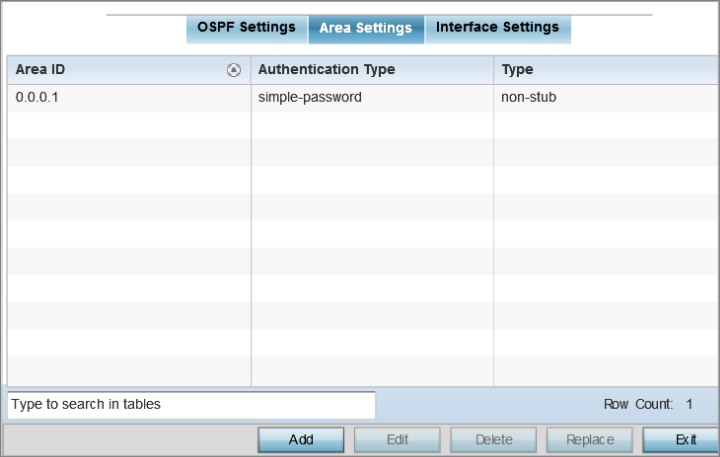

  1. Select the Area Settings tab.
    The OSPF Area main screen displays. This screen lists existing OSPF Area configurations.
    OSPF - Area Setting Configuration Screen
  2. Review existing Area Settings configurations:
    Area ID
    Displays either the IP address or integer representing the OSPF area.
    Authentication Type
    Lists the authentication schemes used to validate the credentials of dynamic route connections.
    Type
    Lists the OSPF area type in each listed configuration.
  3. To apply overrides, select an area entry from those listed on the screen, and click Edit.
    You can also add new area configurations or delete existing configurations.
    The add/edit OSPF Area screen displays.

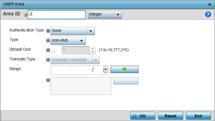

    OSPF - Add/Edit OSPF Area Configuration Screen
  4. Set the OSPF Area configuration.
    Area ID
    Use the drop-down menu and specify either an IP address or Integer for the OSPF area.
    Authentication Type
    Select either None, simple-password or message-digest as credential validation scheme used with the OSPF dynamic route. The default setting is None.
    Type
    Set the OSPF area type as either stub, totally-stub, nssa, totally-nssa or non-stub.
    Default Cost
    Select this option to set the default summary cost advertised if creating a stub. Set a value from 1 - 16, 777,215.
    Translate Type
    Define how messages are translated. Options include translate-candidate, translate-always and translate-never. The default setting is translate-candidate.
    Range
    Specify a range of addresses for routes matching address/mask for OSPF summarization.
  5. Click OK to save the area configuration changes.
