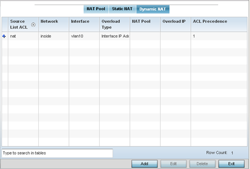

  1. Select the Dynamic NAT tab.
    The Dynamic NAT main screen displays by default.
    NAT Configuration - Dynamic NAT Main Screen
  2. Review the following to determine whether a new dynamic NAT configuration needs to be created, or whether an existing one can be edited or deleted:
    Source List ACL
    Lists an ACL to define the packet selection criteria for the NAT configuration. NAT is applied only on packets which match a rule defined in the access-list. These addresses (once translated) are not exposed to the outside world when the translation address is used to interact with the remote destination.
    Network
    Displays Inside or Outside NAT as the network direction for the dynamic NAT configuration.
    ACL Precedence
    Lists the administrator-assigned priority set for the listed source list ACL. The lower the value listed, the higher the priority assigned to this ACL rule.
    Interface
    Lists the VLAN (from 1 - 4094) used as the communication medium between the source and destination points within the NAT configuration.
    Overload Type
    Displays the overload type used when several internal addresses are NATed to only one or a few external addresses. Options include NAT Pool, One Global Address and Interface IP Address. The default setting is Interface IP Address.
    NAT Pool
    Displays the name of an existing NAT pool used with the dynamic NAT configuration.
    Overload IP
    If One Global IP Address is selected as the Overload Type, define an IP address to use as a filter address for the IP ACL rule.
  3. To modify an existing dynamic NAT configuration, select it and click Edit. To remove an existing configuration, select it and click Delete.
  4. To create a new dynamic NAT configuration, click Add.

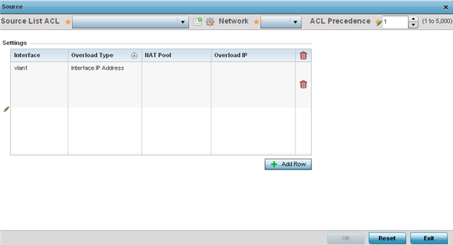

    The Source window displays.
    Profile Overrides - Security - NAT - Dynamic NAT - Source ACL List Screen
  5. Set or override the following to define the Dynamic NAT configuration:
    Source List ACL
    Select an ACL name to define the packet selection criteria for NAT. NAT is applied only on packets which match a rule defined in the access-list. These addresses (once translated) will not be exposed to the outside world when the translation address is used to interact with the remote destination.
    Network
    Select Inside or Outside NAT as the network direction for the dynamic NAT configuration. Inside is the default setting.
    ACL Precedence
    Set the priority (from 1 - 5000) for the source list ACL. The lower the value, the higher the priority assigned to the ACL rule.
    Interface
    Select the VLAN (from 1 - 4094) or WWAN used as the communication medium between the source and destination points within the NAT configuration. Ensure that the VLAN selected adequately supports the intended network traffic within the NAT supported configuration.
    Overload Type
    Define the overload type used when several internal addresses are NATed to only one or a few external addresses. Options include NAT Pool, One Global Address, and Interface IP Address. The default setting is Interface IP Address.
    NAT Pool
    Provide the name of an existing NAT pool for use with the dynamic NAT configuration.
    Note:
    This option is enabled only if the Overload Type is set or NAT Pool.
    Overload IP
  6. Click OK to save the dynamic NAT configuration changes.
