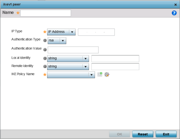

    Profile Security - VPN IKE Policy - Add IKE Peer Screen
    Name
    If you are creating a new peer configuration (remote gateway) for VPN tunnel connection, assign it a 32-character maximum name to distinguish it from other with similar attributes.
    IP Type
    Enter either the IP address or the FQDN hostname of the IPSec VPN peer used in the tunnel setup. A hostname cannot exceed 64 characters.
    Authentication Type
    Select the authentication type used by the VPN peer. The options are: PSK or rsa. RSA is an algorithm for public key cryptography. It is the first algorithm known to be suitable for signing and encryption If using IKEv2, this screen displays both local and remote authentication options, because both ends of the VPN connection require authentication.
    RSA is the default value for both local and remote authentication, regardless of whether IKEv1 or IKEv2 is used.
    Authentication Value
    Define the authentication string (shared secret) shared by both ends of the VPN tunnel connection. The string must be between 8 - 21 characters long. If using IKEv2, both a local and remote string must be specified for handshake validation at both ends (local and remote) of the VPN connection.
    Local Identity
    Select the local identifier used with this peer configuration for an IKE exchange with the target VPN IPSec peer. Options include IP Address, Distinguished Name, FQDN, email, string, autogen-uniqueid. The default setting is string.
    Remote Identity
    Select the remote identifier used with this peer configuration for an IKE exchange with the target VPN IPSec peer. Options include IP Address, Distinguished Name, FQDN, email, and string. The default setting is string.
    IKE Policy Name
    Select the IKEv1 or IKE v2 policy name (and settings) to apply to this peer configuration. If you need to create a new policy, click the Create icon.
