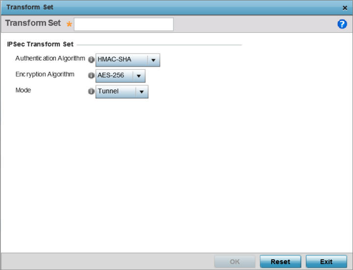

  1. Click Add to define a new transform set configuration, Edit to modify an existing configuration, or Delete to remove an existing transform set.
    Profile Security - VPN Transform Set Create/Modify Screen
  2. Define the following settings for the new or modified transform set configuration:
    Name
    If you are creating a new transform set, define a 32-character maximum name to differentiate this configuration from others with similar attributes.
    Authentication Algorithm
    Set the transform sets‘s authentication scheme used to validate identity credentials. Use the drop-down menu to select either HMAC-SHA, HMAC-MD5, sha256-hmac or aes-xcbc-mac. The default setting is HMAC-SHA.
    Encryption Algorithm
    Set the transform set encryption method for protecting transmitted traffic. Options include DES, 3DES, AES, AES-192, and AES-256. The default setting is AES-256.
    Mode
    Select either Tunnel or Transport as the IPSec tunnel type used with the transform set. The Tunnel option is used for site-to-site VPN and Transport is used for remote VPN deployments. The default setting is Tunnel.
  3. Click OK to save the changes made in the Transform Set screen.
