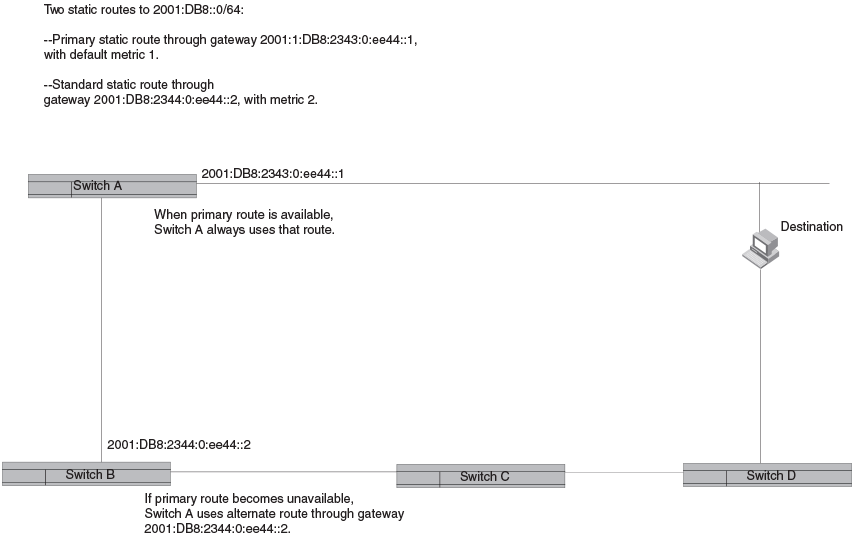

Two static routes to same destination

    This example creates two next-hop gateways for all 2001:DB8::0/64 destinations. Traffic alternates between the two paths.

    device(config)# ipv6 route 2001:DB8::0/64 2001:DB8:2344:0:ee44::2 2
    This example creates an alternate route to all 2001:DB8::0/64 destinations. The primary route uses 2001:DB8:2343:0:ee44::1 as the next hop. The route has the default metric of 1 (the default metric is not entered in the CLI). If this path is not available, traffic is directed through 2001:DB8:2344:0:ee44::2, which has the next lowest metric of 2.
