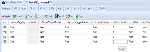

- Double-click a white-shaded
field to edit the value.

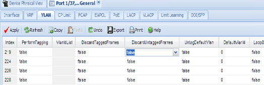

- Click the arrow in
the list field to view the options, and then select the appropriate
value.
- In a text-entry field,
double-click, and then edit the value.
