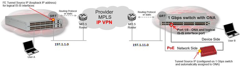

This example shows a typical Fabric Extend deployment with a 10/40/100 Gbps switch in the core and a 1 Gbps switch in one of the branch offices. The 10/40/100 Gbps switch supports Fabric Extend natively and is connected over an IP network to a 1 Gbps switch, which requires an ONA to encapsulate SPB traffic with a VXLAN header. The ONA sets up a bridge between the ONA device-side port and the ONA network-side port. Fabric Extend uses a VXLAN tunnel to send traffic to and from the 10/40/100 Gbps switch through the 1 Gbps switch to the ONA.
This deployment uses the GRT so the tunnel source IP address must be on the GRT, not on a VRF.
If IP Shortcuts is enabled, you must configure an IS-IS accept policy or exclude route-map to ensure that tunnel destination IP addresses are not learned through IS-IS.
Add any IP address used for setting up the logical tunnel (such as local network and loopback IP addresses) to the IS-IS accept policy or exclude route-map to prevent these addresses from being advertised into IS-IS.

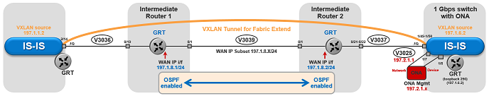

The following figure shows a sample Fabric Extend deployment over IP using the GRT.
(The tunnel source IP address is configured in the GRT.)
Switch(config)# interface GigabitEthernet 2/14 Switch(config-if)# no shutdown Switch(config-if)# default-vlan-id 0 Switch(config-if)# name "ospf-intf-SP-core" Switch(config-if)# brouter port 2/14 vlan 3036 subnet 197.1.1.2/255.255.255.0 Switch(config-if)# no spanning-tree mstp force-port-state enable Switch(config-if)# ip ospf enable Switch(config-if)# exit Switch(config)# router isis Switch(config-isis)# ip-tunnel-source-address 197.1.1.2 Switch(config-isis)# exit Switch(config)# logical-intf isis 255 dest-ip 197.1.6.2 name "Tunnel-to-Branch1" Switch(config-isis-255-197.1.6.2)# isis Switch(config-isis-255-197.1.6.2)# isis spbm 1 Switch(config-isis-255-197.1.6.2)# isis enable Switch(config-isis-255-197.1.6.2)# exit Switch(config)# ip prefix-list "isis-tunnel-addr" 197.1.0.0/16 ge 16 le 32 Switch(config)# route-map "deny-isis-tunnel-network" 1 Switch(route-map)# no permit Switch(route-map)# enable Switch(route-map)# match network "isis-tunnel-addr" Switch(route-map)# match protocol isis Switch(route-map)# exit Switch(config)# router isis Switch(config-isis)# accept route-map "deny-isis-tunnel-network" Switch(config-isis)# exit Switch(config)# isis apply accept
(The tunnel source address is a CLIP address on the GRT. This address is configured on the 1 Gbps switch and then automatically assigned to the ONA.)
Switch(config)# interface loopback 256 Switch(config-if)# ip address 256 197.1.6.2/255.255.255.0 Switch(config-if)# ip ospf 256 Switch(config-if)# exit Switch(config)# interface GigabitEthernet 1/7-1/8; enables ports to ONA Switch(config-if)# no shutdown Switch(config-if)# exit Switch(config)# vlan create 3037 name "ospf-intf-SP-core" type port-mstprstp 0 Switch(config)# vlan members 3037 1/49-1/50 portmember Switch(config)# mlt 11 Switch(config)# mlt 11 encapsulation dot1q Switch(config)# mlt 11 mem 1/49-1/50 Switch(config)# mlt 11 vlan 3037 Switch(config)# interface vlan 3037 Switch(config-if)# ip address 197.1.11.2 255.255.255.0 0 Switch(config-if)# ip ospf enable Switch(config-if)# exit Switch(config)# vlan create 3025 name "ONA-Mgmt-vlan" type port-mstprstp 0 Switch(config)# vlan members 3025 1/7 portmember Switch(config)# interface vlan 3025 Switch(config-if)# ip address 197.2.1.1 255.255.255.0 3 Switch(config-if)# exit Switch(config)# ip dhcp-relay fwd-path 197.2.1.1 197.10.1.11 Switch(config)# ip dhcp-relay fwd-path 197.2.1.1 197.10.1.11 enable Switch(config)# ip dhcp-relay fwd-path 197.2.1.1 197.10.1.11 mode bootp_dhcp Switch(config)# router isis Switch(config-isis)# ip-tunnel-source-address 197.1.6.2 port 1/8 mtu 1950 Switch(config-isis)# exit Switch(config)# logical-intf isis 255 dest-ip 197.1.1.2 name "Tunnel-to-HQ" Switch(config-isis-255-197.1.1.2)# isis Switch(config-isis-255-197.1.1.2)# isis spbm 1 Switch(config-isis-255-197.1.1.2)# isis enable Switch(config-isis-255-197.1.1.2)# exit Switch(config)# ip prefix-list "isis-tunnel-addr" 197.1.0.0/16 ge 16 le 32 Switch(config)# route-map "deny-isis-tunnel-network" 1 Switch(route-map)# no permit Switch(route-map)# enable Switch(route-map)# match network "isis-tunnel-addr" Switch(route-map)# match protocol isis Switch(route-map)# exit Switch(config)# router isis Switch(config-isis)# accept route-map "deny-isis-tunnel-network" Switch(config-isis)# exit Switch(config)# isis apply accept
Intermediate routers are typically configured by an Internet service provider (ISP). The following configurations are for reference only.
Switch(config)# interface GigabitEthernet 8/19 Switch(config-if)# default-vlan-id 0 Switch(config-if)# name "ospf-intf-from-Headoffice" Switch(config-if)# no shutdown Switch(config-if)# brouter port 8/19 vlan 3036 subnet 197.1.1.3/255.255.255.0 mac-offset 2 Switch(config-if)# ip ospf enable Switch(config-if)# exit Switch(config)# vlan create 3039 name "core-ospf-vlan" type port-mstprstp 0 Switch(config)# vlan members 3039 8/1 portmember Switch(config)# interface Vlan 3039 Switch(config)# ip address 197.1.8.1 255.255.255.0 2 Switch(config)# ip ospf enable Switch(config)# exit
Switch(config)# vlan create 3039 name "core-ospf-vlan" type port-mstprstp 0 Switch(config)# vlan members 3039 8/1 portmember Switch(config)# interface Vlan 3039 Switch(config)# ip address 197.1.8.2 255.255.255.0 0 Switch(config)# ip ospf enable Switch(config)# exit Switch(config)# vlan create 3037 name "ospf-intf-from-branch1" type port-mstprstp 0 Switch(config)# vlan members 3037 8/21-8/22 portmember Switch(config)# mlt 11 Switch(config)# mlt 11 encapsulation dot1q Switch(config)# mlt 11 mem 8/21-8/22 Switch(config)# mlt 11 vlan 3037 Switch(config)# interface Vlan 3037 Switch(config)# ip address 197.1.11.1 255.255.255.0 5 Switch(config)# ip ospf enable Switch(config)# exit
