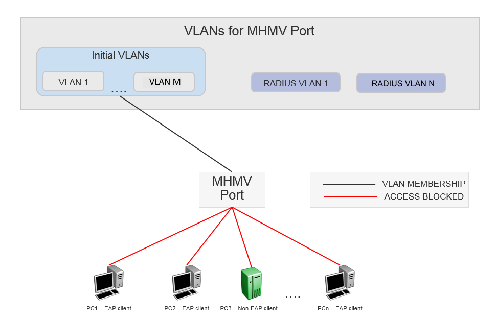

Clients (n) connect to a switch port. The maximum number of clients (EAP + NEAP) allowed on a port is 8192.
EAP is enabled and the default operation mode is MHMV.
Modify client counters to authenticate n clients.
Initial VLANs are the VLANS which are manually set up before EAP is enabled.
Port default VLAN ID is equal to one of the initial VLAN ID.
All clients are unauthenticated, hence the clients cannot access the network.
The clients cannot access the network as they are not authenticated.

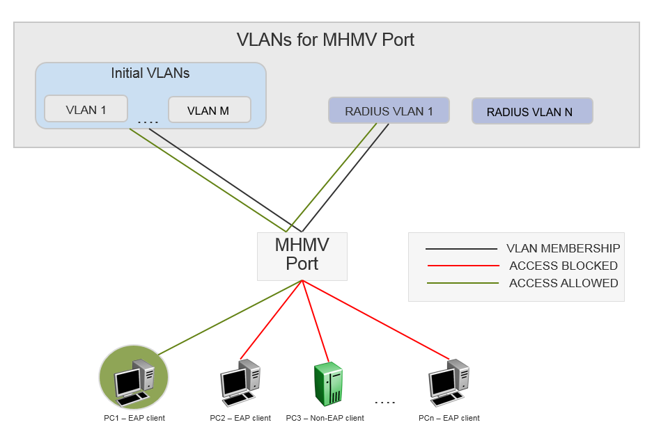

Client PC1 receives RADIUS VLAN attribute:
The port is left in all initial VLANs and added to the VLAN corresponding to the RADIUS VLAN attribute.
Port default VLAN remains unchanged.
A VLAN MAC based rule is configured for client PC1.
Using the VLAN MAC based capabilities, the untagged traffic from PC1 goes to the RADIUS assigned VLAN 1 as shown in the figure below.
Client PC1 can access all initial VLANs using tagged frames.
The remaining clients stay unauthenticated and cannot access any VLANs.
PC1 is authenticated with RADIUS VLAN 1. The other clients cannot access the network as they are unauthenticated.
