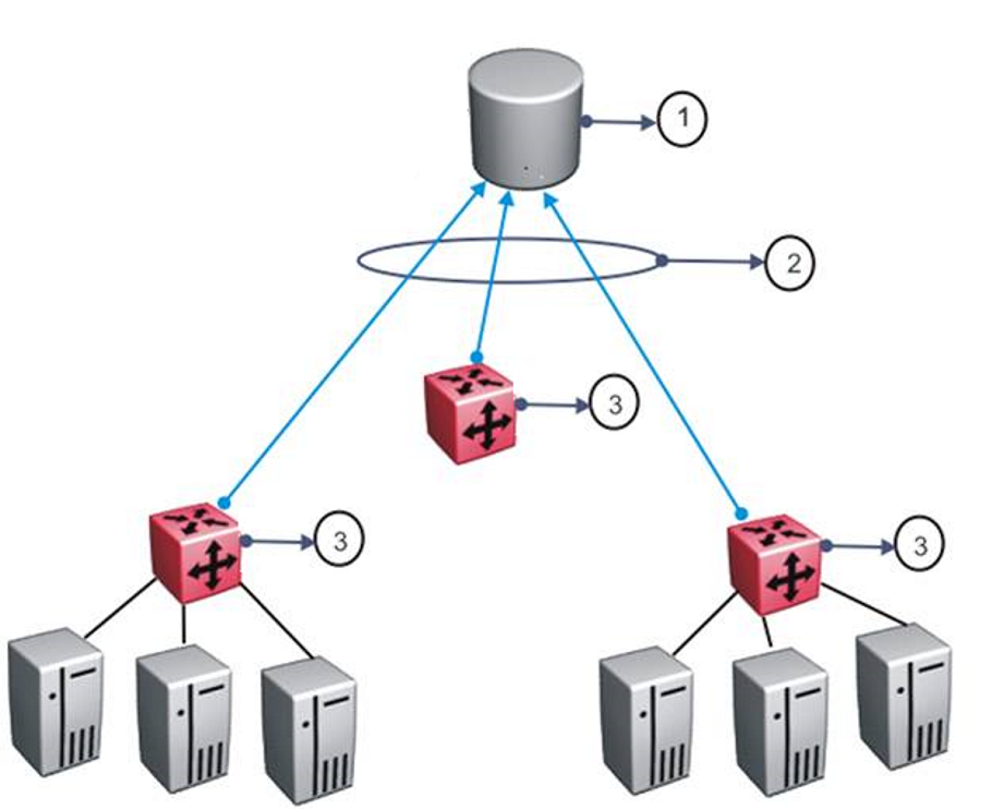

The following figure shows the sFlow agent on various routers and switches with sFlow datagrams being sent to the sFlow collector.
Number |
Description |
1 |
sFlow collector |
2 |
sFlow datagrams |
3 |
sFlow agents |
