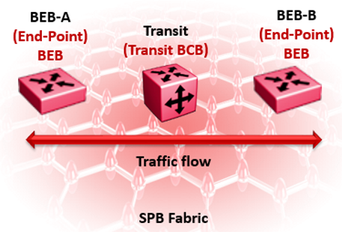

Use the following example to verify FAN Transit information on a transit node between two end-point SPB nodes, BEB-A and BEB-B.
Verification on BEB-A:
You can execute the following commands on either BEB-A or BEB-B. The following example displays the sample outputs for BEB-A.

Verify that the transit node is in the SPB path between the FAN end-points BEB-A and BEB-B. 4058 and 4059 are the SPB B-VIDs.
You can view the SPB B-VIDs by executing the command show isis spbm.
BEB-A:1#show isis spbm unicast-tree 4058 Node:646a.52ce.0484 (BEB-B) -> Node:f873.a202.53df (TRANSIT) -> ROOT Node:f873.a202.53df (TRANSIT) -> ROOT
BEB-A:1#show isis spbm unicast-tree 4059 Node:646a.52ce.0484 (BEB-B) -> Node:f873.a202.53df (TRANSIT) -> ROOT Node:f873.a202.53df (TRANSIT) -> ROOT
Verify that the transit node is a part of the FAN tree:
BEB-A:1#l2 tracetree-fan Please wait for l2tracetree to complete or press any key to abort l2tracetree to b1:ad:aa:41:9c:84, vlan 4058 i-sid 16777001 nickname 0.11.03 hops 64 1 BEB-A b0:ad:aa:41:9c:84 -> TRANSIT f8:73:a2:02:53:df 2 TRANSIT f8:73:a2:02:53:df -> BEB-B 64:6a:52:ce:04:84
