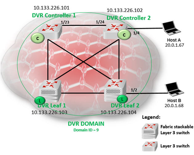

The following section describes a simple configuration example to configure Distributed Virtual Routing (DvR) over a Fabric Connect (SPB) network.
In this example, you configure two DvR Controllers (with IP addresses 10.133.226.101 and 10.133.226.102) and two DvR Leaf nodes (with IP addresses 10.133.226.103 and 10.133.226.104), in a single DvR domain with domain ID 9. Hosts connect to the DvR nodes as shown in the figure.

DvR Leaf configuration — Leaf 1 and Leaf 2
Caution
Ensure that you save the current configuration on the switch, before you enable the flag.
Enabling the flag removes all existing non-DvR configuration on the switch, such as platform VLANs and their IP address configuration, CLIP configuration, routing protocol configuration and VRF configuration. The gateway IPv4 address, if configured, is also removed.
On switch with IP address 10.133.226.104, configure the boot flag and reboot the switch.
Switch3:1>en Switch3:1#conf t Enter configuration commands, one per line. End with CNTL/Z. Switch3:1(config)#boot config flags dvr-leaf-mode Switch3:1(config)#save config Switch3:1(config)#reset
On switch with IP address 10.133.226.105, configure the boot flag and reboot the switch.
Switch4:1>en Switch4:1#conf t Enter configuration commands, one per line. End with CNTL/Z. Switch4:1(config)#boot config flags dvr-leaf-mode Switch4:1(config)#save config Switch4:1(config)#reset
Configure switch with IP address 10.133.226.104 as DvR Leaf 1; verify the configuration.
Switch3:1(config)#dvr Leaf 9
