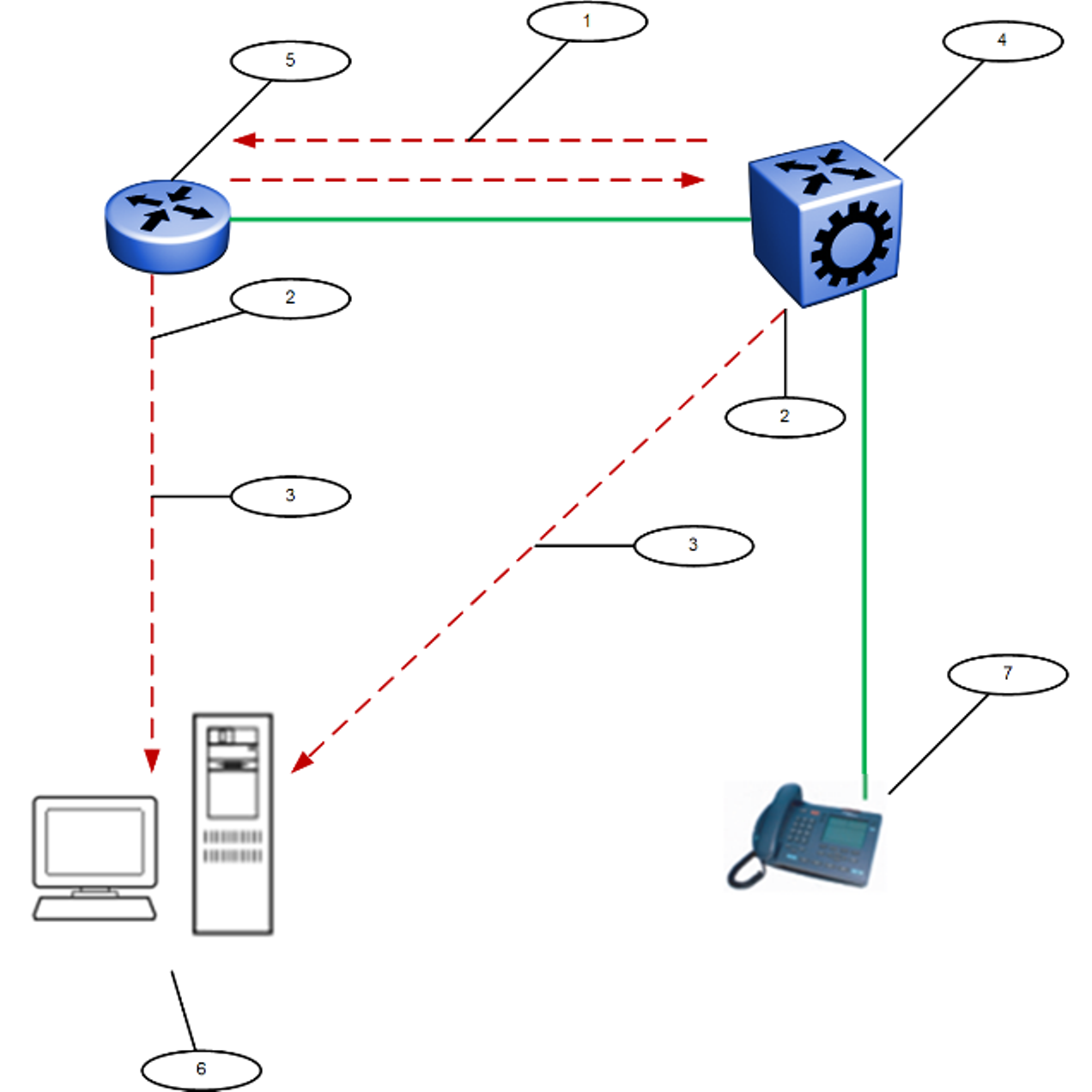

The following figure shows an example of a LAN using LLDP.
Legend:
The switch and an LLDP-enabled router advertise chassis and port IDs and system descriptions to each other
The devices store the information about each other in local MIB databases, accessible with SNMP
A network management system retrieves the data stored by each device and builds a network topology map
Switch
Router
Management work station
IP Phone
