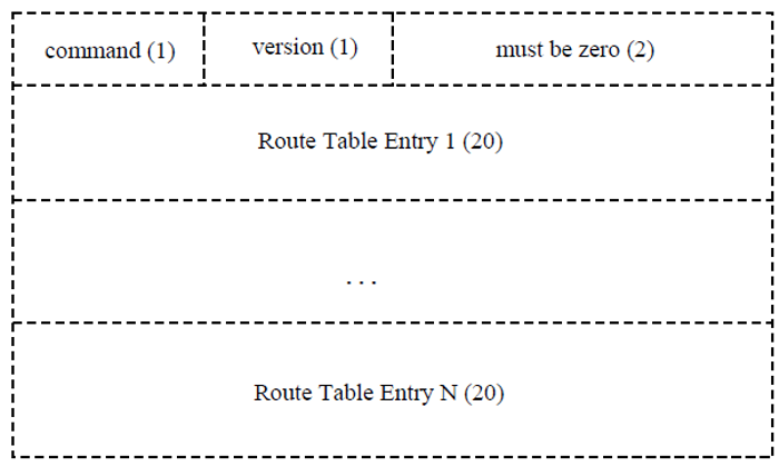

RIPng-enabled routers use UDP port 521 (the RIPng port) to send and receive datagrams.
command: Specifies the purpose of the message.
version: The version of RIPng.
