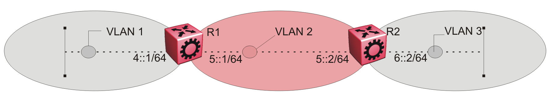

The switch supports IPv6 routing between subnets.
When you add an IP address to the VLAN, the system maps an IP subnet to the VLAN.
As shown in the following figure, although VLAN 1 and VLAN 2 reside on the same switch, for traffic to flow from VLAN 1 to VLAN 2, you must route the traffic.
