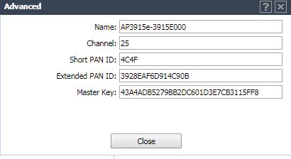

Advanced Thread Gateway Properties
Configure the following parameters on the selected AP. The AP serves as a border gateway router for its own Thread Network.
IoT Thread Gateway Properties
Graphics/iot_thread_gw_parms.png
The configured Thread Gateway displays on the Active Clients report, indicating that the gateway is up and running.
Field Description
Application Determines application type. Select Thread Gateway
Name Thread Network name. Default value is the AP serial number. Each AP creates a separate Thread Network identified with separate Short PAN ID and Extended PAN ID.
Channel The IEEE Standard: 802.15.4 AP channel number.
Short PAN ID A 16-bit, MAC-layer addressing field used in RF data transmissions between devices in a Thread Network. The default value is derived from the AP serial number. The Short PAN ID identifies the APs Thread Network.
Extended PAN ID A 64-bit, MAC-layer addressing field used in RF data transmissions between devices in a Thread Network. The default value is derived from the AP serial number. This value must be unique. It is used for a more specific network identification.
Master Key Indicates the Network Master Key used to encrypt communication between nodes in a Thread Network.
