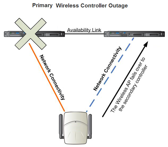

Session availability enables wireless APs to switch over to a standby (secondary) wireless controller fast enough to maintain the mobile user‘s session availability in the following scenarios:

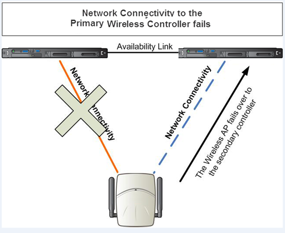

AP Fail Over When Connectivity to Primary Fails
Graphics/Avail_Network_Outage.png
The secondary controller does not have to detect its link failure with the primary controller for the session availability to kick in. If the AP loses five consecutive polls to the primary controller either due to the controller outage or connectivity failure, it fails over to the secondary controller fast enough to maintain the user session.
In session availability mode (Session Availability Mode), the APs connect to both the primary and secondary controllers. While the connectivity to the primary controller is via the “active” tunnel, the connectivity to the secondary controller is via the “backup” tunnel.
