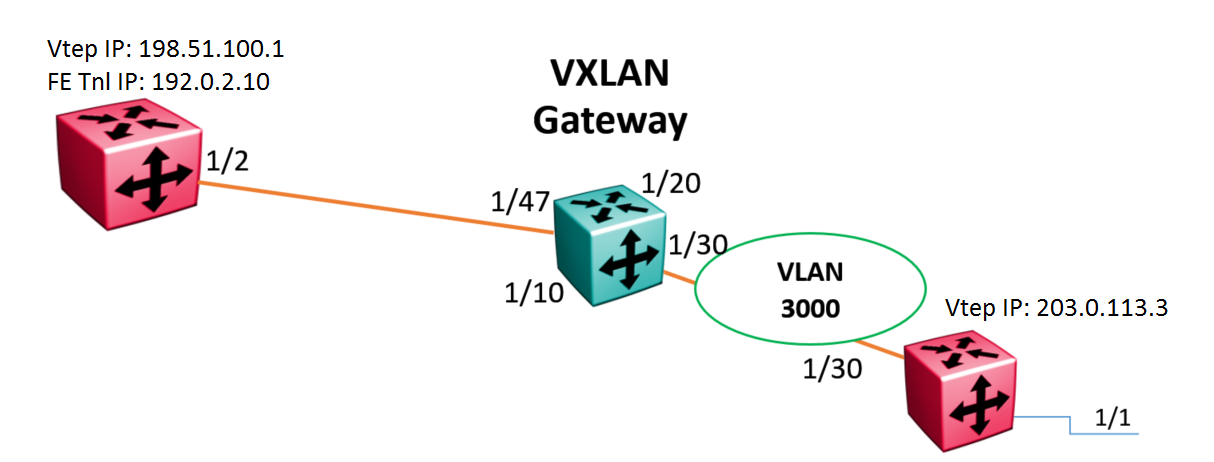

This example shows how to configure the VXLAN Gateway. Remember that there are two modes:
Base Interworking Mode is the default mode so there is no need to set the mode boot flag. However, you should use the show boot config flags command to verify that the vxlan-gw-full-interworking-mode is set to false.
Full Interworking Mode supports all SPB functionality including vIST and SMLT using an internal loopback. Full Interworking Mode is not the default mode. To configure Full Interworking mode, you must enable the vxlan-gw-full-interworking-mode boot flag.
