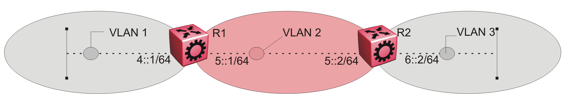

Virtual routing between IPv6 subnets
The switch supports IPv6 routing between subnets.
When you add an IP address to the VLAN, the system maps an IP subnet to the VLAN.
As shown in the following figure, although VLAN 1 and VLAN 2 reside on the same switch, for traffic to flow from VLAN 1 to VLAN 2, you must route the traffic.
You must enable IPv6 forwarding to route IPv6 traffic between VLANs. And you must enable IPv6 both globally and on a specific VLAN basis in order for forwarding to function. You can enable or disable IPv6, either globally or on a specific VLAN basis.
IPv6 forwarding is enabled by default.
IPv6 routing between VLANs
