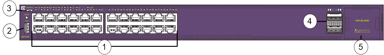

The following diagram illustrates the components of the front panel of the 5520-24T switch. Slot 1 is used for the 24 copper ports and the two QSFP28/QSFP+ ports, and slot 2 is used for Versatile Interface Module (VIM) ports, if a VIM is installed in the VIM slot.
24 10/100/1000BASE-T full-duplex (FDX), half-duplex (HDX), MACsec-capable ports
1 USB A port
1 USB micro B management port
2 Universal Ethernet QSFP28 ports
VIM slot (shown with VIM covered). Port numbering depends on the type of VIM installed in the slot.
The back panel (not shown) includes an RJ-45 out of band (OOB) management port, an RJ-45 console port, a USB A port, locator LED, two PSU slots, and hot-swappable fan units.

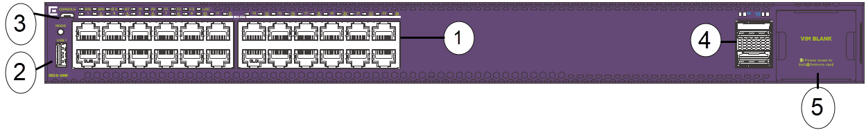

The following diagram illustrates the components of the front panel of the 5520-24W switch. Slot 1 is used for the 24 copper ports and the two QSFP28/QSFP+ ports, and slot 2 is used for Versatile Interface Module (VIM) ports, if a VIM is installed in the VIM slot.
24 10/100/1000BASE-T FDX/HDX 802.3bt Type 4 PoE MACsec-capable ports
1 USB A port

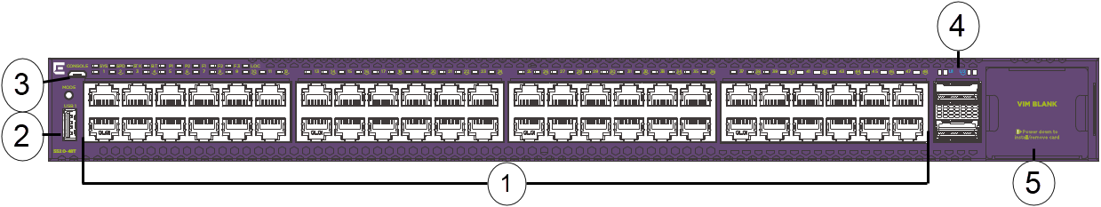

The following diagram illustrates the components of the front panel of the 5520-48W switch. Slot 1 is used for the 48 copper ports and the two QSFP28/QSFP+ ports, and slot 2 is used for Versatile Interface Module (VIM) ports, if a VIM is installed in the VIM slot.
48 10/100/1000BASE-T FDX/HDX 802.3bt Type 4 PoE MACsec-capable ports
1 USB A port

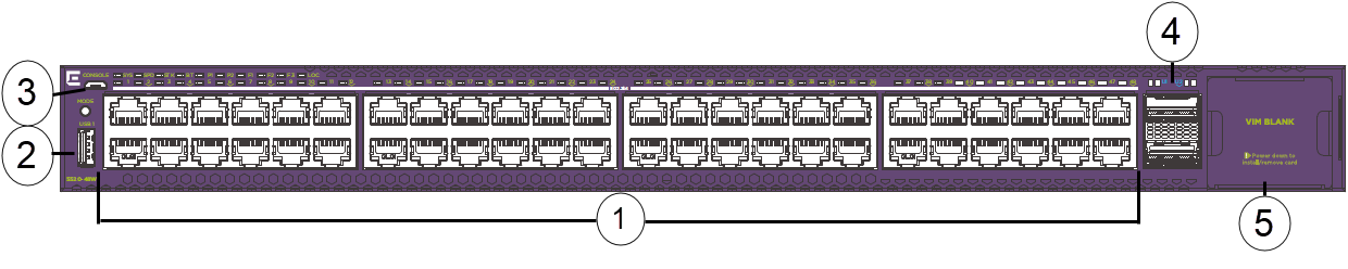

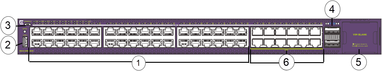

The following diagram illustrates the components of the front panel of the 5520-12MW-36W switch. Slot 1 is used for the 48 copper ports and the two QSFP28/QSFP+ ports, and slot 2 is used for Versatile Interface Module (VIM) ports, if a VIM is installed in the VIM slot.
36 10/100/1000BASE-T FDX/HDX 802.3bt Type 4 PoE MACsec-capable ports
1 USB A port
12 100 Mbps/1 Gbps/2.5 Gbps/5 Gbps 802.3bt Type 4 PoE MACsec-capable ports

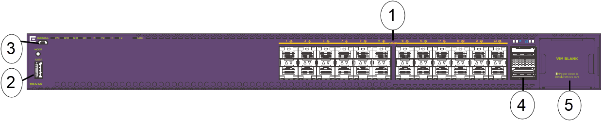

The following diagram illustrates the components of the front panel of the 5520-24X switch. Slot 1 is used for the 24 SFP+ ports and the two QSFP28/QSFP+ ports, and slot 2 is used for Versatile Interface Module (VIM) ports, if a VIM is installed in the VIM slot.
24 100/1000BASE-X/10GBASE-X SFP+ ports
1 USB A port

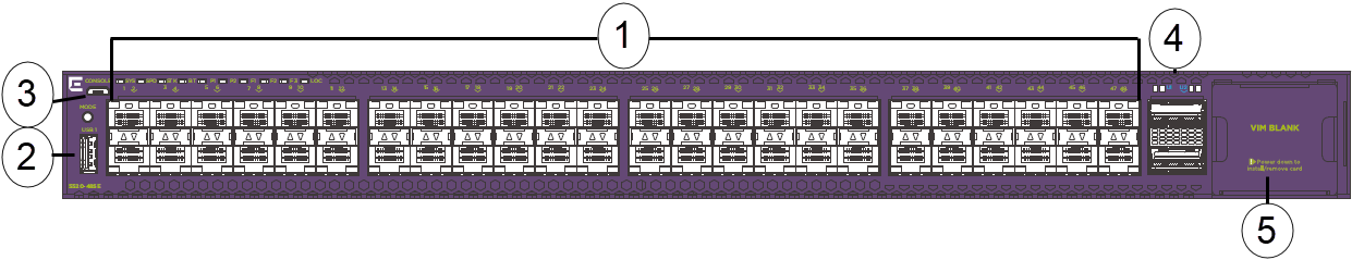

The following diagram illustrates the components of the front panel of the 5520-48SE switch. Slot 1 is used for the 48 SFP ports and the two QSFP28/QSFP+ ports, and slot 2 is used for Versatile Interface Module (VIM) ports, if a VIM is installed in the VIM slot.
48 100/1000BASE-X MACsec-capable SFP ports
1 USB A port
