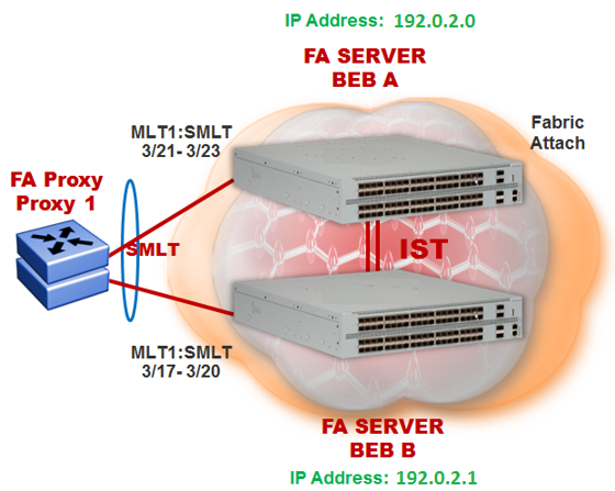

The following example describes FA configuration and behavior in a dual-homed SMLT deployment.
The following figure shows a simple FA solution in a dual-homed SMLT deployment. In this deployment, a pair of BEB switches (BEB A and BEB B) operating as IST peers are configured as the FA Server. An access switch or a wiring closet switch configured as an FA Proxy connects to the FA Server. The FA Proxy advertises I-SID-to-VLAN assignment mappings to the FA Server. Both BEB switches receive the mapping information using LLDP PDUs containing assignment TLVs. The switch that learns the mapping first considers the I-SID to be discovered locally and creates the I-SID on its device. The mapping information is then shared with its IST peer switch. When the peer switch receives the mapping across IST in a new SMLT message, it too creates the I-SID on its device. This I-SID however, is considered to be discovered remotely because it is learnt from synchronization with the peer switch. The mappings can also be learned on the FA Server from both LLDP PDUs and from IST synchronization.
Ensure that the proxy device (for example, an access switch) is properly configured for FA. See the corresponding product documentation for information on how to configure FA on the switch.

Configure BEB A and BEB B as the FA Server
Perform the following configuration on each switch.

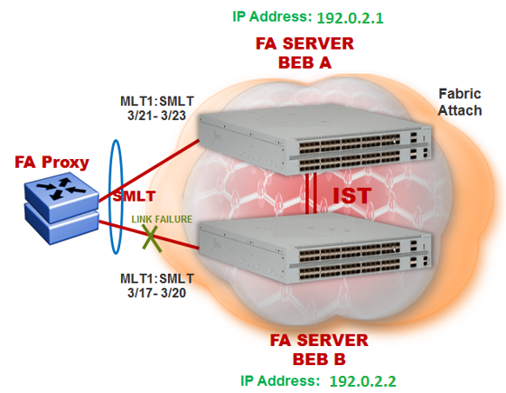

The following section describes the behavior if, for example, a link failure occurs between the FA Proxy and BEB B, as shown in the following figure.
View the I-SID-to-VLAN assignments on BEB A:
Switch:1(config)#show fa assignment 3/21
Fabric Attach Assignment Map
Interface I-SID Vlan State Origin
3/21 2 2 active proxy
3/21 3 3 active proxy
3/21 4 4 active proxy
View the Switched UNI (ELAN) I-SIDs created on BEB A.
Switch:1(config)#show i-sid elan
Isid Info
ISID ISID PORT MLT ORIGIN ISID
ID TYPE VLANID INTERFACES INTERFACES NAME
2 ELAN N/A - c2:1 - --- - -l- - ISID-2
3 ELAN N/A - c3:1 - --- - -l- - ISID-3
4 ELAN N/A - c4:1 - --- - -l- - ISID-4
ORIGIN Legend:
C: manually configured; D: discovered by FA or EPT
M: FA management; E: discovered by EAP; A: auto-sense
l: discover by local switch r: discover by remote VIST switch
8k_fanout:1(config-if)#shlw mlt i-sid
View the I-SID information for MLT 1 on BEB A.
Switch:1(config)#show mlt i-sid 1
MLT Isid Info
ISID ISID
MLTID IFINDEX ID VLANID C-VID TYPE ORIGIN ISID BPDU
NAME
1 6144 2 N/A 2 ELAN - --- - -l- - ISID-2
1 6144 3 N/A 3 ELAN - --- - -l- - ISID-3
1 6144 4 N/A 4 ELAN - --- - -l- - ISID-4
3 out of 3 Total Num of i-sid endpoints displayed
ORIGIN Legend:
View the Switched UNI (ELAN) I-SIDs created on BEB B.
BEB-B:1(config-mlt)#show i-sid elan
Isid Info
2 ELAN N/A - c2:1 - --- - --r - ISID-2
3 ELAN N/A - c3:1 - --- - --r - ISID-3
4 ELAN N/A - c4:1 - --- - --r - ISID-4
ORIGIN Legend:
