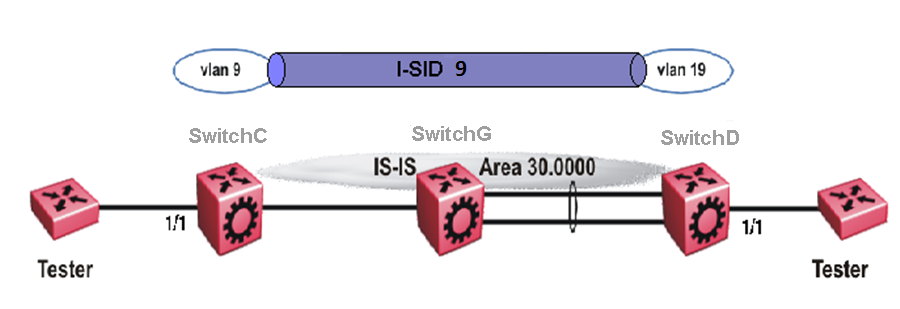

The following figure shows a sample Layer 2 VSN deployment where the C- VLAN IDs are different at each end. You must first configure basic SPBM and IS-IS infrastructure. For more information, see SPBM configuration examples.
The following sections show the steps required to configure the Layer 2 VSN parameters in this example.
VLAN CONFIGURATION vlan create 9 type port 1 vlan members 9 1/1 portmember vlan i-sid 9 9
VLAN CONFIGURATION vlan create 19 type port 1 vlan members 19 1/1 portmember vlan i-sid 19 9
