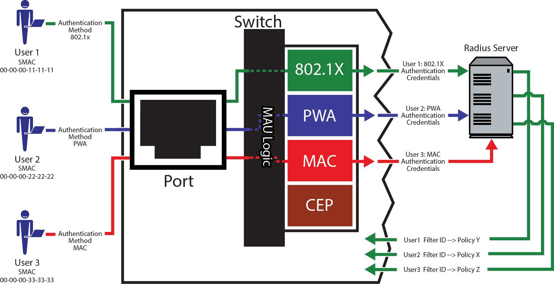

In Authenticating Multiple Users With Different Methods on a Single Port, multiple users are authenticated on a single port each with a different authentication method (in this example only 802.1X, PWA, MAC, and CEP are enabled on the device). In this case, each user on a single port successfully authenticates with a different authentication type. The authentication method is included in the authentication credentials sent to the RADIUS server. RADIUS looks up the user account for that user based upon the SMAC. The filter ID for that user is returned to the switch in the authentication response, and the authentication is validated for that user.

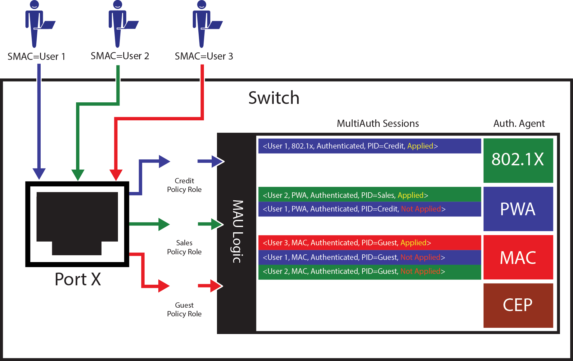

In Selecting Authentication Method When Multiple Methods are Validated, full MultiAuth authentication takes place in that multiple users on a single port are validated for more than one authentication method. The applied authentication and policy are based upon the authentication method precedence level. On the far right column of the figure, the enabled authentication methods are listed from top to bottom in order of precedence. User 1 is authenticating with both the 802.1x and PWA methods, with the Credit policy. Both the 802.1x and PWA authentication methods are validated, but only the 802.1x MultiAuth session is applied, because that has the highest precedence. User 2 is authenticating with both PWA and MAC methods, with the Sales policy. PWA, having a higher precedence than MAC, is the MultiAuth session applied for User 2. User 3 is a guest and is authenticating with the MAC method only. The MAC MultiAuth session, with the Guest policy is applied for User 3.
