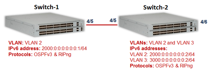

In this example, you configure OSPFv3 and RIPng routes on two switches Switch-1 and Switch-2, as shown in the following figure.
VLAN configuration:
On Switch-1, configure VLAN 2 and the IPv6 interface address 2000:0:0:0:0:0:0:1/64.

On Switch-2, configure VLAN 2 and VLAN 3 with the IPv6 interfaces 2000:0:0:0:0:0:0:2/64 and 3000:0:0:0:0:0:0:2/64 respectively.

On Switch-1 and Switch-2, the route 3000:0:0:0:0:0:0:2/64 is learned using the protocols RIPng and OSPFv3. The OSPFv3 route is learned as the best route because of its route preference value of 20. The RIPng route is added as alternative route because it has the route preference 100, which is greater than the OSPFv3 route preference of 20. On Switch-2, the route 3000:0:0:0:0:0:0:2/64 is a local route.
Viewing route and alternative route configuration on Switch-1:
Switch1:1(config)#show ipv6 route alternative
IPv6 Routing Table Information - GlobalRouter
Destination Address/PrefixLen NEXT HOP VID/BID/TID PROTO COST AGE TYPE PREF
2000:0:0:0:0:0:0:1/64 39-4900-24XE V-2 LOCAL 1 0 B 0
3000:0:0:0:0:0:0:2/64 VSP-8404 V-2 OSPF 2 0 B 20
3000:0:0:0:0:0:0:2/64 VSP-8404 V-2 RIP 2 0 A 100
3 out of 3 Total Num of Route Entries displayed.
TYPE Legend:
A=Alternative Route, B=Best Route, E=Ecmp Route
2 out of 2 Total Num of Route Entries displayed.
TYPE Legend:
Viewing route and alternative route configuration on Switch-2:
Switch2:1(config)#show ipv6 route alternative
2000:0:0:0:0:0:0:2/64 39-4900-24XE V-2 LOCAL 1 0 B 0
3000:0:0:0:0:0:0:2/64 VSP-8404 V-2 LOCAL 2 0 B 20
3000:0:0:0:0:0:0:2/64 VSP-8404 V-2 LOCAL 2 0 A 100

On the switch, default preferences are assigned to all standard routing protocols. You can modify the global preference for a protocol to give it a higher or lower priority than other protocols. When you change the preference for a static route, if all best routes remain best routes, only the local route tables change. However, if changing the protocol preference causes best routes to no longer be best routes, neighboring route tables can be affected.
In the following example scenario, you configure a different routing preference for the RIPng protocol on Switch-1 and observe the learning of best and alternative routes. The existing route preference for RIPng is 100.
Switch1:1#show ipv6 route alternative
TYPE Legend:
TYPE Legend:
Configure a different route preference for the RIPng protocol, for example, 19:
Switch1:1#configure terminal Enter configuration commands, one per line. End with CNTL/Z. Switch1:1(config)#ipv6 route preference protocol ripng 19 Switch1:1(config)#exit
Verify the route preference configuration:
Switch1:1#show ipv6 route preference
IPv6 Route Preference - GlobalRouter
PROTOCOL DEFAULT CONFIG
LOCAL 0 0
STATIC 5 5
SPBM_L1 7 7
OSPFv3_INTRA 20 20
OSPFv3_INTER 25 25
EBGP 45 45
RIPNG 100 19
OSPFv3_E1 120 120
OSPFv3_E2 125 125
IBGP 175 175
View the updated route preference (for RIPng) on Switch-1. The RIPng route is now learned as the best route because its route preference value (19) is lower than that of OSPFv3 (20), as shown here.
3000:0:0:0:0:0:0:2/64 VSP-8404 V-2 RIP 2 0 B 19
TYPE Legend:
3000:0:0:0:0:0:0:2/64 VSP-8404 V-2 OSPF 2 0 A 20
TYPE Legend:
