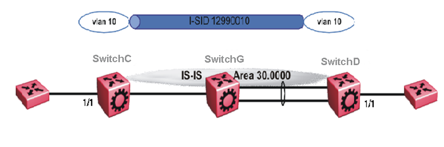

The following figure shows a sample Layer 2 VSN deployment.
Layer 2 VSN
The following sections show the steps required to configure the Layer 2 VSN parameters in this example. You must first configure basic SPBM and IS-IS infrastructure. For more information, see: SPBM configuration examples.
SwitchC
VLAN CONFIGURATION
vlan create 10 type port-mstprstp 1
vlan members 10 1/1 portmember
vlan i-sid 10 12990010
SwitchD
VLAN CONFIGURATION
