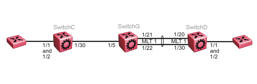

The following figure shows a sample greenfield deployment for SPBM.
![](GUID-060A5E02-8007-4544-9C94-EF4AD591BF97-low.png)
![Note](images/note.png)
For migration purposes, SPBM can coexist with existing SMLT configurations.
The following sections show the steps required to configure the Ethernet and MLT interfaces in this example.
SwitchC
PORT CONFIGURATION - PHASE 1 interface GigabitEthernet 1/30 encapsulation dot1q exit
SwitchG
PORT CONFIGURATION - PHASE 1 interface GigabitEthernet 1/5 encapsulation dot1q exit MLT CONFIGURATION mlt 1 enable mlt 1 member 1/21-1/22 mlt 1 encapsulation dot1q
SwitchD
MLT CONFIGURATION mlt 1 enable mlt 1 member 1/20,1/30 mlt 1 encapsulation dot1q

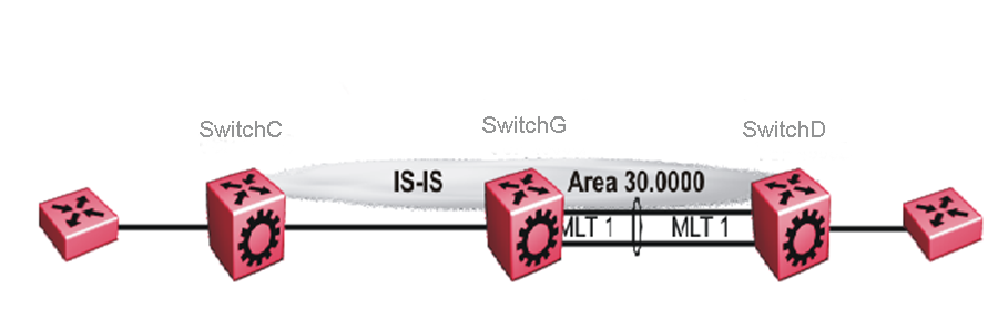

The following figure shows the IS-IS area information added to the network.
![](GUID-6B7EC7AA-4E6F-4B5A-AE5E-05DCC4ADE422-low.png)
The following sections show the steps required to configure the global IS-IS SPBM parameters in this example.
SwitchC
enable configure terminal prompt SwitchC BOOT CONFIGURATION spbm spbm ethertype 0x8100 ISIS SPBM CONFIGURATION router isis spbm 1 spbm 1 nick-name f.30.13 spbm 1 b-vid 20 ISIS CONFIGURATION is-type l1 manual-area 30.0000 sys-name SwitchC exit router isis enable VLAN CONFIGURATION vlan create 20 name "B-VLAN" type spbm-bvlan
SwitchG
enable configure terminal prompt SwitchG BOOT CONFIGURATION spbm spbm ethertype 0x8100 ISIS SPBM CONFIGURATION router isis spbm 1 spbm 1 nick-name f.30.10 spbm 1 b-vid 20 ISIS CONFIGURATION is-type l1 manual-area 30.0000 sys-name SwitchG exit router isis enable VLAN CONFIGURATION vlan create 20 name "B-VLAN" type spbm-bvlan
SwitchD
enable configure terminal prompt SwitchD BOOT CONFIGURATION spbm spbm ethertype 0x8100 ISIS SPBM CONFIGURATION router isis spbm 1 spbm 1 nick-name f.30.14 spbm 1 b-vid 20 ISIS CONFIGURATION is-type l1 manual-area 30.0000 sys-name SwitchD exit router isis enable VLAN CONFIGURATION vlan create 20 name "B-VLAN" type spbm-bvlan

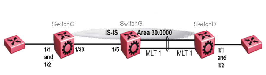

The following figure shows the IS-IS area information and interfaces in the network.
![](GUID-35FC74EA-4835-4CBA-9ADD-DD70B9DC9D97-low.png)
The following sections show the steps required to configure the IS-IS SPBM interfaces in this example.
SwitchC
PORT CONFIGURATION - PHASE II interface GigabitEthernet 1/30 isis isis spbm 1 isis enable exit
SwitchG
PORT CONFIGURATION - PHASE II interface GigabitEthernet 1/5 isis isis spbm 1 isis enable exit MLT INTERFACE CONFIGURATION interface mlt 1 isis isis spbm 1 isis enable exit
SwitchD
Verify SPBM Operations
The following sections show the output from verifying the sample IS-IS SPBM configuration.
Checking Operation — SwitchC
SwitchC:1# show isis interface =================================================================================================================== ISIS Interfaces =================================================================================================================== IFIDX TYPE LEVEL OP-STATE ADM-STATE ADJ UP-ADJ SPBM-L1 OP-SPBM- ORIGIN AREA AREA-NAME -METRIC L1-METRIC -------------------------------------------------------------------------------------------------------------------- Port1/30 pt-pt Level 1 UP UP 1 1 10 (A) 10 CONFIG HOME area-9.00.02 -------------------------------------------------------------------------------------------------------------------- Home: 1 out of 1 Total Num of ISIS Interfaces -------------------------------------------------------------------------------------------------------------------- Legend: (A): l1 metric is automatically updated based on detected interface speed.
SwitchC:1# show isis adjacencies ==================================================================================================== ISIS Adjacencies ==================================================================================================== INTERFACE L STATE UPTIME PRI HOLDTIME SYSID HOST-NAME STATUS AREA AREA-NAME ---------------------------------------------------------------------------------------------------- Port1/30 1 UP 1d 19:19:52 22 beb0.0000.7204 SwitchC ACTIVE HOME area-9.00.02 ---------------------------------------------------------------------------------------------------- Home: 1 out of 1 interfaces have formed an adjacency Remote: 0 out of 0 interfaces have formed an adjacency ----------------------------------------------------------------------------------------------------
SwitchC:1# show isis spbm unicast-fib ================================================================================================== SPBM UNICAST FIB ENTRY INFO ================================================================================================== DESTINATION BVLAN SYSID HOST-NAME OUTGOING COST AREA AREA-NAME ADDRESS INTERFACE -------------------------------------------------------------------------------------------------- 00:0e:62:25:a3:df 4000 0016.ca23.73df SwitchG 1/30 10 HOME area-9.00.02 00:14:0d:a0:13:df 4000 0014.0da0.13df SwitchD 1/30 10 HOME area-9.00.02 -------------------------------------------------------------------------------------------------- Home: Total number of SPBM UNICAST FIB entries 2 Remote: Total number of SPBM UNICAST FIB entries 0 -------------------------------------------------------------------------------------------------- SwitchC:1# show isis spbm unicast-tree 4000 Node:000e.6225.a3df.00 (SwitchG) -> ROOT Node:0014.0da0.13df.00 (SwitchD) -> Node:000e.6225.a3df.00 (SwitchG) -> ROOT
Checking Operation — SwitchG
SwitchG:1# show isis interface =================================================================================================================== ISIS Interfaces =================================================================================================================== IFIDX TYPE LEVEL OP-STATE ADM-STATE ADJ UP-ADJ SPBM-L1 OP-SPBM- ORIGIN AREA AREA-NAME -METRIC L1-METRIC -------------------------------------------------------------------------------------------------------------------- Port1/5 pt-pt Level 1 UP UP 1 1 10 (A) 10 CONFIG HOME area-9.00.02 Mlt1 pt-pt Level 1 UP UP 1 1 10 (A) 10 CONFIG HOME area-9.00.02 -------------------------------------------------------------------------------------------------------------------- Home: 2 out of 2 Total Num of ISIS Interfaces -------------------------------------------------------------------------------------------------------------------- Legend: (A): l1 metric is automatically updated based on detected interface speed.
SwitchG:1# show isis adjacencies ==================================================================================================== ISIS Adjacencies ========================================================================================================= INTERFACE L STATE UPTIME PRI HOLDTIME SYSID HOST-NAME STATUS AREA AREA-NAME --------------------------------------------------------------------------------------------------------- Port1/30 1 UP 1d 19:19:52 127 26 beb0.0000.7204 SwitchC ACTIVE HOME area-9.00.02 Mlt1 1 UP 04:57:34 127 20 0014.0da0.13df SwitchD ACTIVE HOME area-9.00.02 --------------------------------------------------------------------------------------------------------- Home: 2 out of 2 interfaces have formed an adjacency Remote: 0 out of 0 interfaces have formed an adjacency ----------------------------------------------------------------------------------------------------
SwitchG:1# show isis spbm unicast-fib ================================================================================================== SPBM UNICAST FIB ENTRY INFO ================================================================================================== DESTINATION BVLAN SYSID HOST-NAME OUTGOING COST AREA AREA-NAME ADDRESS INTERFACE -------------------------------------------------------------------------------------------------- 00:14:0d:a0:13:df 4000 0014.0da0.13df SwitchD MLT-1 10 HOME area-9.00.02 00:15:e8:9f:e3:df 4000 0015.e89f.e3df SwitchC 1/5 10 HOME area-9.00.02 -------------------------------------------------------------------------------------------------- Home: Total number of SPBM UNICAST FIB entries 2 Remote: Total number of SPBM UNICAST FIB entries 0 -------------------------------------------------------------------------------------------------- SwitchG:1# show isis spbm unicast-tree 4000 Node:0015.e89f.e3df.00 (SwitchC) -> ROOT Node:0014.0da0.13df.00 (SwitchD) -> ROOT
Checking Operation — SwitchD
SwitchD:1# show isis interface =================================================================================================================== ISIS Interfaces =================================================================================================================== IFIDX TYPE LEVEL OP-STATE ADM-STATE ADJ UP-ADJ SPBM-L1 OP-SPBM- ORIGIN AREA AREA-NAME -METRIC L1-METRIC -------------------------------------------------------------------------------------------------------------------- Mlt1 pt-pt Level 1 UP UP 1 1 10 (A) 10 CONFIG HOME area-9.00.02 -------------------------------------------------------------------------------------------------------------------- Home: 1 out of 1 Total Num of ISIS Interfaces -------------------------------------------------------------------------------------------------------------------- Legend: (A): l1 metric is automatically updated based on detected interface speed.
SwitchD:1# show isis adjacencies ===================================================================================================== ISIS Adjacencies ===================================================================================================== INTERFACE L STATE UPTIME PRI HOLDTIME SYSID HOST-NAME STATUS AREA AREA-NAME ----------------------------------------------------------------------------------------------------- Mlt1 1 UP 05:03:59 127 21 000e.6225.a3df SwitchG ACTIVE HOME area-9.00.02 ----------------------------------------------------------------------------------------------------- Home: 1 out of 1 interfaces have formed an adjacency Remote: 0 out of 0 interfaces have formed an adjacency -----------------------------------------------------------------------------------------------------
SwitchD:1# show isis spbm unicast-fib ================================================================================================== SPBM UNICAST FIB ENTRY INFO ================================================================================================== DESTINATION BVLAN SYSID HOST-NAME OUTGOING COST AREA AREA-NAME ADDRESS INTERFACE -------------------------------------------------------------------------------------------------- 00:0e:62:25:a3:df 4000 000e.6225.a3df SwitchG MLT-1 10 HOME area-9.00.02 00:15:e8:9f:e3:df 4000 0015.e89f.e3df SwitchC MLT-1 10 HOME area-9.00.02 -------------------------------------------------------------------------------------------------- Home: Total number of SPBM UNICAST FIB entries 2 Remote: Total number of SPBM UNICAST FIB entries 0 -------------------------------------------------------------------------------------------------- SwitchD:1# show isis spbm unicast-tree 4000 Node:000e.6225.a3df.00 (SwitchG) -> ROOT Node:0015.e89f.e3df.00 (SwitchC) -> Node:000e.6225.a3df.00 (SwitchG) -> ROOT
