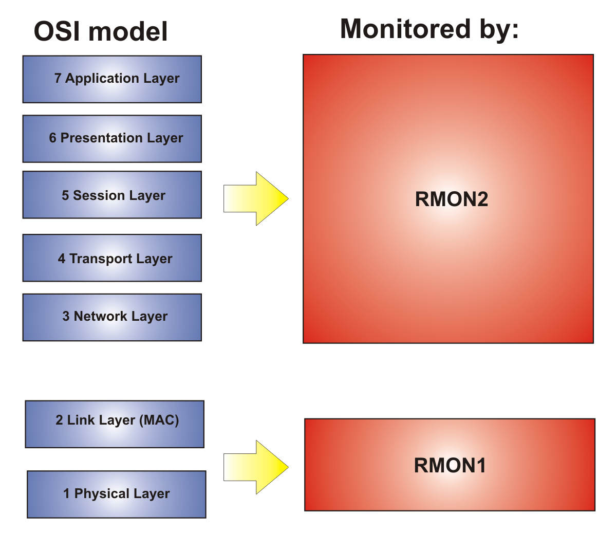

The following figure shows which form of RMON monitors which layers in the OSI model:
![](GUID-0DA3E788-2C94-46F4-B0FE-9C3EFF01EE6E-low.png)
