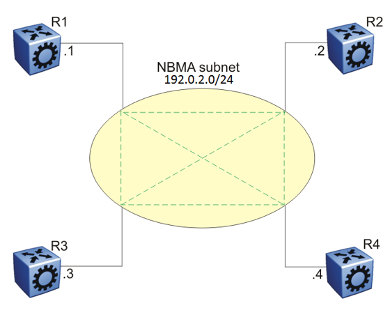

The following figure shows an example of four routers attached to an NBMA subnet. The NBMA segment uses a single IP subnet and each router uses an IP address within the subnet.
OSPF treats an NBMA network much like it treats a broadcast network. Because many routers attach to the network, the Hello protocol elects a designated router (DR) to generate the network link-state advertisements.

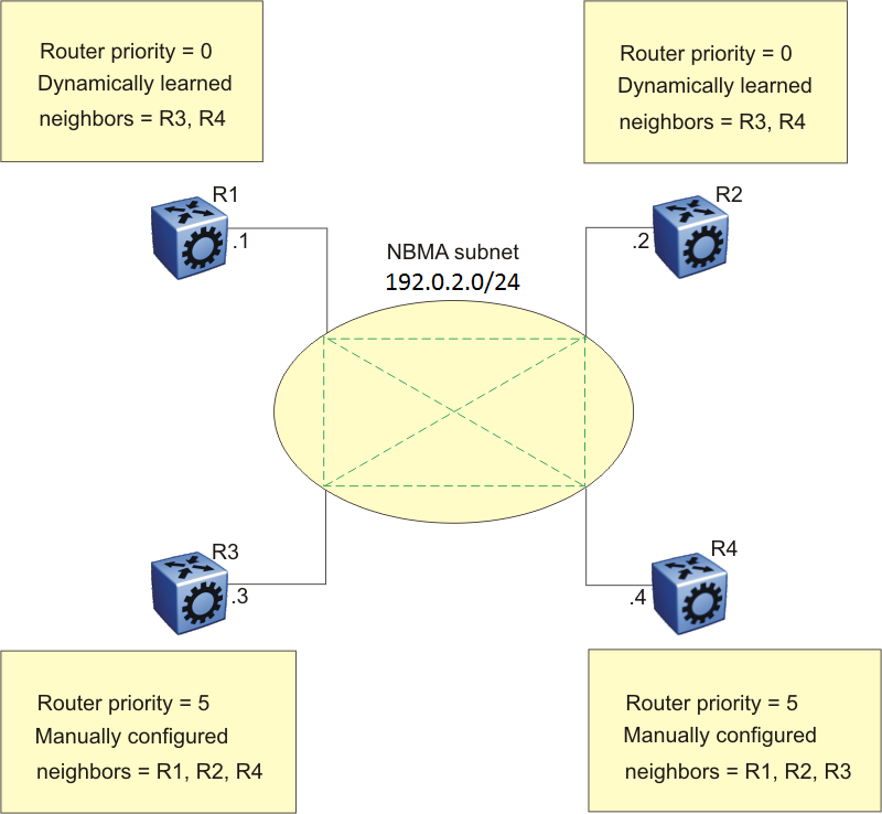

The following figure shows an NBMA subnet with router priorities and manually configured neighbors.
Because R1 and R2 have a router priority of 0, they are not eligible to become the DR. Also, R1 and R2 do not require configuration of a neighbors list; R1 and R2 discover neighbors dynamically through the Hello protocol.
R3 and R4 both have a positive, nonzero priority and are eligible to become the DR. Manually configure neighbor lists on R3 and R4.
To create this NBMA network, configure the following parameters:
On each router: NBMA interface type, poll interval, router priority
On R3: R1, R2, and R4 as neighbors
On R4: R1, R2, and R3 as neighbors
If all routers start at the same time, the routers perform the following steps:
R3 and R4 send each other a hello packet to elect a DR.
The Hello protocol elects R3 as the DR, and R4 as the BDR.
R3 (DR) and R4 (BDR) send hello packets to all other routers on the NBMA subnet to synchronize their link-state databases and establish themselves as DR and BDR.
R1 and R2 reply to R3 and R4.
R3 and R4 each form three adjacencies (one with each router on the NBMA subnet).
R1 and R2 each form two adjacencies (one with the DR and one with the BDR).
