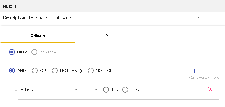

Select a filter to add to this Wireless Clients/BSS Device Action Manager rule set by clicking the Criteria tab. By default the Basic option is selected.
Click the
icon within the
Criteria tab to add a new filter rule to this rule
set.
Use the AND, OR, NOT (AND), and NOT (OR) logical constructs to create your rule. You can add up to twenty file (25) filter rules to this Device Action Manager rule set.

Use the Filter drop-down list to select the rule to apply.
Next, use the Comparison Criteria drop-down list to select the comparison operator for this filter rule. The operator indicates the relationship between the filter and a value that you specify.
The selection in this list will vary with the filter selected in the Filter field. Some of the most common comparison operators are:

For each filter, there will be one or more values that you compare for taking action. The kind and number of value or values will depend on the filter that you have selected. Enter a value that is appropriate for the filter criteria. Any errors that you make will be flagged immediately.
To remove a rule that you have configured, select the red X icon located to the right of each rule. When you click this icon, the rule is immediately deleted from this rule set.
