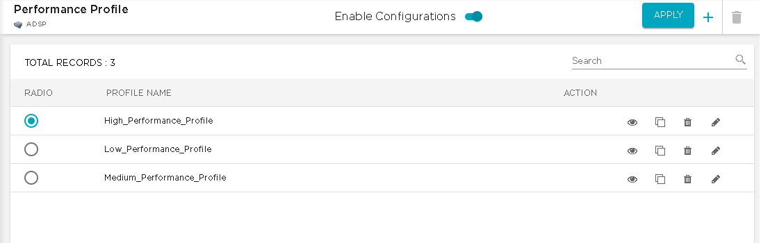

View Performance Profile
Use the Performance Profile screen to view a list of all performance profiles configured for this Extreme AirDefense system.
Performance Profiles Screen
The screen displays the following information:
Field Description
Profile Name The name of the Performance Profile.
Action
The actions that can be performed on the Performance Profile. The icons in this field enable you to manage your profile. You can edit the profile, create a new one by creating a duplicate of an existing rule set, or delete it.
The following actions can be performed:
  • View - To view a Performance Profile, use the icon for the profile. The details for this profile is displayed in a separate dialog.
  • Duplicate - Use the icon to create a duplicate of the selected Performance Profile. A duplicate of this profile is created and the configuration dialog displays the newly created Performance Profile. Customize the duplicate profile further to meet your requirements.
  • Delete - Use the icon to delete the selected Performance Profile.
  • Edit - Use the to edit the Performance Profile. A configuration dialog displays where you can make changes to the selected profile.
