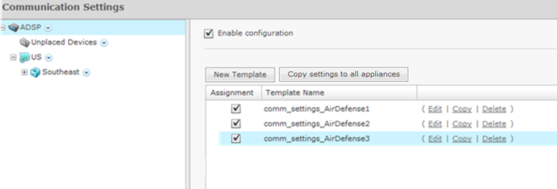

Once you have defined a Communication Settings Profile, you must apply it to your system. To configure Communication Settings, you must first select the Enable configuration checkbox to activate the settings.
You should always configure Communication Settings at the appliance level. When you do, the configuration is inherited for all the other levels. Then, if you have a level that needs a different configuration, you can apply that profile to that level using the override feature.

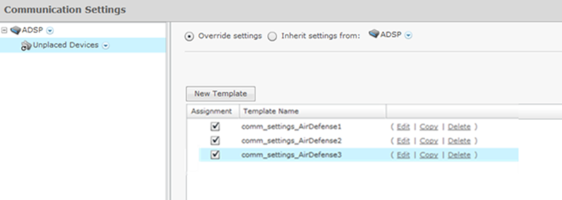

For example, if most of the network devices require a console to interface with it, you can configure the Communication Settings for console interface at the appliance level. Then, if you have a small group of devices that require you to interface with it through a web UI, you can configure the Communication Settings for HTTP interface and override the appliance level configuration by selecting another network level.
The Override settings option is available when you select (highlight) a network level below the appliance level. Use the Expand button to reveal the other levels.
You may select multiple Communication Settings Profiles by checking more than one checkbox. If more than one profile is selected, ADSP will attempt to find the best match to apply starting at the top of the list and working its way down to the bottom of the list.
