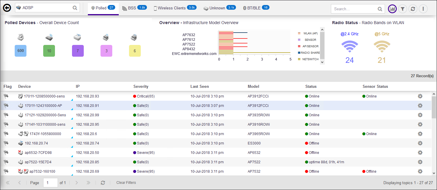

Polled devices are those devices that AirDefense classifies as Network Devices. Network Devices are devices that are a part of your network and have been assigned an IP address in your network. Network Devices include, switches, wireless controllers, routers, access points, and sensors. These are the devices that AirDefense communicates with to push or pull data and configuration.
The Polled Device tab displays a set of widgets on the top of the display area. The widgets are:
The Devices table displays the following information for each Polled device:

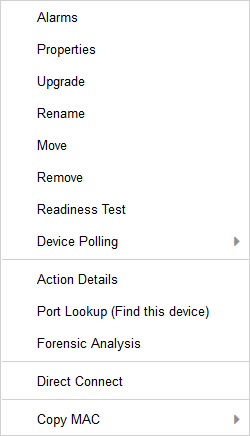

The following actions can be performed on a each device listed in the table. Select the icon to display the list of actions that can be performed. The actions that can be performed are different for the different device types.
Action
Description
Alarms
Displays the Alarms for the device. When selected, the alarms for this device are displayed in the Alarms screen
Properties
Displays the properties of the device. Select this item to view the properties of the selected device.
Upgrade
Select this menu item to upgrade the selected device to the latest available firmware.
Rename
Select this menu item to rename this device. Use this menu item to configure a meaningful name for this device. A small window displays. Use this Rename window to provide a name for this device.

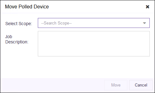

Move
Select this menu item to move this device to a different site/location in the Extreme AirDefense system. A small window displays. Use this window to provide the destination to move the device to.
Remove
Select this menu item to remove the device. A small confirmation window displays. Select Yes to remove the device. Select No to exit without removing the device.
Readiness Test
Select the Readiness Test menu item to check the connections and the communication settings between Extreme AirDefense and the device. A series of test are run and the results are displayed in another window.
Device Polling
Select the Device Polling menu item to run a compliance audit on the device.
Action Details
Select the Action Details menu item to view a table listing specific actions occurring on the device.
Port Lookup (Find this Device)
Use the Port Lookup menu item to scan for and locate this device, in your network, using its MAC address.
Forensic Analysis
Use the Forensic Analysis menu item to analyze the device and provide detailed information on the device. Forensic Analysis returns the threat level of the device, device alarms, and device association details about the device.
Live View
The Live View menu item displays the Live View window for the device where you can view the device's live status and other parameters.
Direct Connect
Select the Direct Connect menu item to directly connect to the device. A new browser window or a browser tab is created for the login screen of the device.
Copy MAC
The Copy MAC menu item is an ease of use feature and enables you to copy the MAC address of the device in hexadecimal or colon hexadecimal notation. Click this menu item to expand it and view MAC formats that can be copied.
Select the MAC format to copy to your PC's clipboard.
