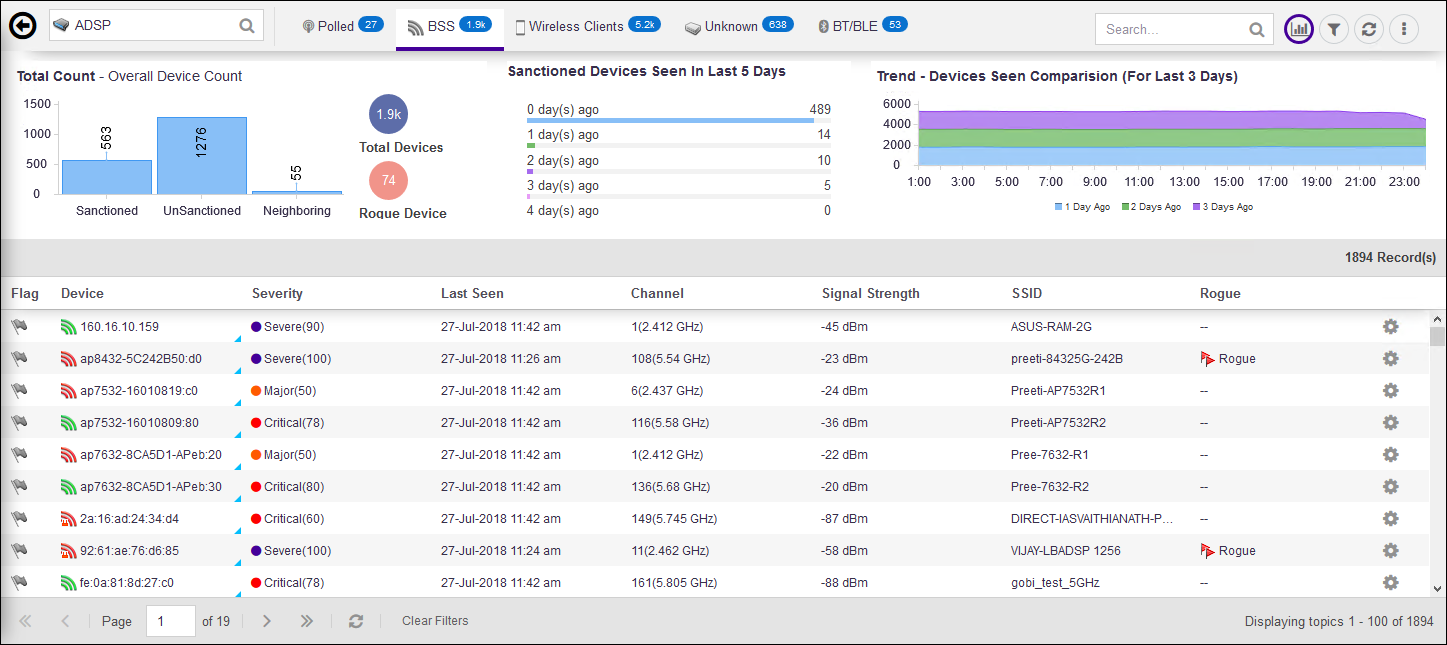

BSS Tab
The BSS tab displays a list of all Basic Service Sets (BSSs), sanctioned or otherwise, that were discovered by Extreme AirDefense in your network during regular scans.
The BSS tab displays a set of widgets on the top of the display area. The widgets are:
The BSS table displays the following information:
Field
Description
Flag
Select the icon to indicate that this device is considered to be of interest. The flag changes to .
Device
This column displays the device type icon and its name. Hover on the name to display more details about the device in a pop-up. The following image is a pop up that displays on hover.
Select the MAC address of the device to view its details in a separate window.
Severity
This column displays the device's threat level to your network. Hover on this value to display a threat score for this device.
  • indicates a severity level of Severe which is higher than the level Critical.
  • indicates a severity level of Critical.
  • indicates a severity level of Major.
  • indicates a severity level of Minor.
  • indicates the site/location is Safe.
Last Seen
This column displays the date and time this device was last seen on the network.
Channel
This column displays the channel and the frequency on which this device was identified.
Signal Strength
This column displays the signal strength for this device.
SSID
This column displays the SSID of the network to which this device is adopted to.
Rogue
This column indicates if a device has been flagged as a Rogue device. All rogue devices are flagged with this icon.
