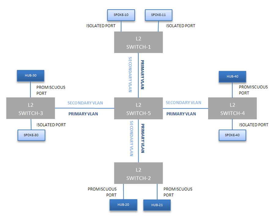

The following figure shows a basic private VLAN topology with private VLAN configured on five switches. All ports connecting to other switches are trunk type ports and all other ports are either promiscuous or isolated ports. On the secondary VLAN, spokes can communicate with hubs, and hubs can communicate with all spokes in the same private VLAN using the primary VLAN, however, spokes cannot communicate with other spokes.
![A network topology of five switches using Private VLANs. A network topology of five switches using Private VLANs.](GUID-C8679796-FD80-454A-874B-AE10A70C477A-low.png)
