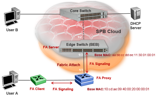

The following section describes a simple configuration example to configure Fabric Attach (FA) at the edge of a Fabric Connect network. This is a typical deployment at its simplest level and is powerful because of its use in conjunction with a Fabric Connect core.
Configuring FA primarily consists of configuring the FA Server. The FA Server in turn discovers neighboring FA component devices (like the FA Proxies and FA Clients) using FA TLVs within the LLDP PDUs.
In the following deployment, the switch at the edge of the Fabric Connect cloud is configured as the FA Server. On this switch, FA is enabled globally and at the interface (port) level. Another switch, functioning as the FA Proxy connects to the FA enabled port (1/3) on the FA Server. User A is an end user device that needs to send and receive data traffic from User B (another end user device) across the network.

Configuration of the edge switch as the FA Server.
Enable FA globally.
Switch:1(config)#fa enable

Verify that the FA Proxy is discovered by the FA Server.
Switch:1(config)#show fa elements
                        Fabric Attach Discovery Elements
                         MGMT                                         ELEM ASGN
PORT   TYPE              VLAN STATE  SYSTEM ID                        AUTH AUTH
1/3    proxy             2    T / S  10:cd:ae:09:40:00:20:00:00:01    AP   AP

Verify neighbor discovery on the FA Proxy switch:
Note that the edge switch (BEB) is discovered as the FA Server by the FA Proxy.
Switch:2(config)#show fa agent Fabric Attach Service Status: Enabled Fabric Attach Element Type: Proxy Fabric Attach Zero Touch Status: Enabled Fabric Attach Auto Provision Setting: Proxy Fabric Attach Provision Mode: SPBM Fabric Attach Client Proxy Status: Enabled Fabric Attach Standalone Proxy Status: Disabled Fabric Attach Agent Timeout: 50 seconds Fabric Attach Extended Logging Status: Enabled Fabric Attach Primary Server Id: aa:bb:cc:dd:ee:11:30:01:00:01 (SPBM) Fabric Attach Primary Server Descr:BEB-Switch (6.0.0.0_GA)
Switch:2(config)#show fa elements Unit/ Element Element Element Port Type Subtype VLAN Auth System ID ------- ------- -------------------- ------- ---- ----------------------------- 1/3 Server Server (Auth) 0 AP aa:bb:cc:dd:ee:11:30:01:00:01
Switch:2(config)#show fa i-sid I-SID VLAN Source Status ------- ---- ------------ ------- 44 2 Proxy Active
