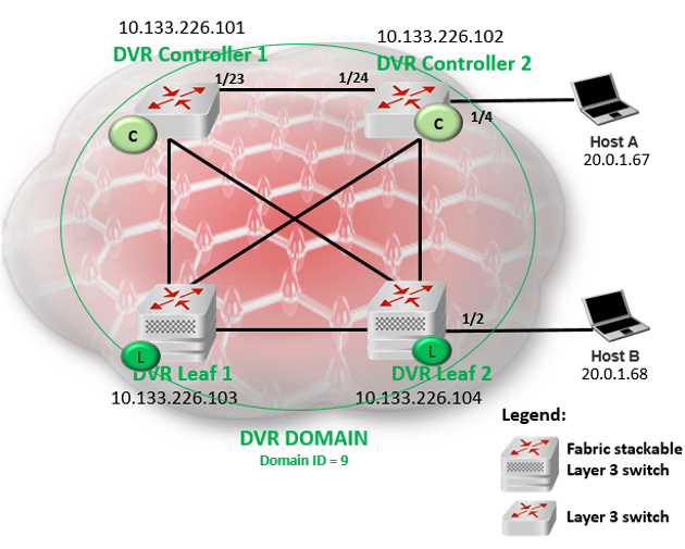

The following section describes a simple configuration example to configure Distributed Virtual Routing (DvR) over a Fabric Connect (SPB) network.
In this example, you configure two DvR Controllers (with IP addresses 10.133.226.101 and 10.133.226.102) and two DvR Leaf nodes (with IP addresses 10.133.226.103 and 10.133.226.104), in a single DvR domain with domain ID 9. Hosts connect to the DvR nodes as shown in the figure.
On the switches to be configured as DvR Controllers:

On the switches to be configured as DvR Leaf nodes:
Ensure that you configure Fabric Connect.
DvR Controller configuration — Controller 1 and Controller 2:

DvR Leaf configuration — Leaf 1 and Leaf 2
Caution
Ensure that you save the current configuration on the switch, before you enable the flag.
Enabling the flag removes all existing non-DvR configuration on the switch, such as platform VLANs and their IP address configuration, CLIP configuration, routing protocol configuration and VRF configuration. The gateway IPv4 address, if configured, is also removed.
On switch with IP address 10.133.226.104, configure the boot flag and reboot the switch.
Switch3:1>en Switch3:1#conf t Enter configuration commands, one per line. End with CNTL/Z. Switch3:1(config)#boot config flags dvr-leaf-mode Switch3:1(config)#save config Switch3:1(config)#reset
On switch with IP address 10.133.226.105, configure the boot flag and reboot the switch.
Switch4:1>en Switch4:1#conf t Enter configuration commands, one per line. End with CNTL/Z. Switch4:1(config)#boot config flags dvr-leaf-mode Switch4:1(config)#save config Switch4:1(config)#reset
Configure switch with IP address 10.133.226.104 as DvR Leaf 1; verify the configuration.
Switch3:1(config)#dvr Leaf 9

                                                         DVR Host-Entries
                 HOST                L3VSN      L2VSN                  DOMAIN
IP-ADDRESS       MAC-ADDRESS         ISID       ISID       PORT        ID     TYPE         NEXT HOP
20.0.1.67        00:00:00:00:00:67   0          20200      1/4          9      DYNAMIC      00:bb:00:00:81:21
20.0.1.68        00:00:00:00:00:68   0          20200      1/2          9      DYNAMIC      00:bb:00:00:81:21
2 out of 2 Total Num of DVR Host Entries displayed
Switch1:1#show dvr members
                                          DVR Members (Domain ID: 2)
System Name                              Nick-Name        Nodal MAC                 Role
Cont-1                                   0.10.01          00:bb:00:00:01:01         Controller
Cont-2                                   0.10.02          00:bb:00:00:01:02         Controller
Leaf1                                    0.10.04          00:bb:00:00:80:04         Leaf
Leaf2                                    0.10.05          00:bb:00:00:80:05         Leaf
4 out of 4 Total Num of DVR Members displayed
