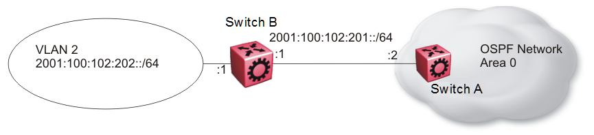

This section shows an example of OSPFv3 configuration. The following figure shows the network.
To complete the configuration, you must perform the following actions:
Configure an IPv6 VLAN (VLAN 2) with port member 1/1.
Configure an IPv6 brouter port (1/2).
Use IPv6 address 2001:100:102::/64.
Configure VLAN 2 and add port members.
vlan create 2 type port-mstprstp 0 vlan mlt 2 4 vlan members 2 1/1 portmember interface vlan 2 ipv6 interface ipv6 interface enable ipv6 interface address 2001:100:102:202:0:0:0:1/64 exit
Enable OSPFv3 on VLAN 2.
# IPV6 OSPF VLAN CONFIGURATION interface vlan 2 ipv6 ospf area 0.0.0.0 ipv6 ospf poll-interval 0 ipv6 ospf enable exit
Create brouter port 1/2 with IPv6 and OSPFv3.
interface gigabitethernet 1/2 ipv6 interface vlan 3999 ipv6 interface enable ipv6 interface address 2001:100:102:201:0:0:0:1/64 ipv6 ospf area 0.0.0.0 ipv6 ospf enable exit
