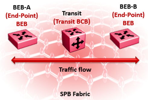

Use the following example to verify FAN Transit information on a transit node between two end-point SPB nodes, BEB-A and BEB-B.
            Verification on BEB-A:
You can execute the following commands on either BEB-A or BEB-B. The following example displays the sample outputs for BEB-A.
Verify that BEB-A is a member of the FAN. The FAN Member attribute displays as Yes.
