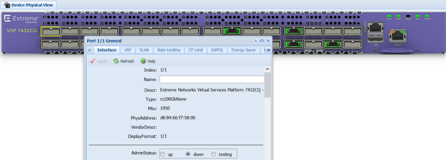

Procedure
  1. Select the Device Physical View tab.
  2. In the Device Physical View, select a port. In this example, right-click port 1.
  3. In the Port shortcut menu, click Edit General.
  4. Select and drag the Port 1/1 General tab wherever you want on the screen as shown in the following figure.
  5. To reposition the tab anywhere on the screen, Select and drag the title bar.

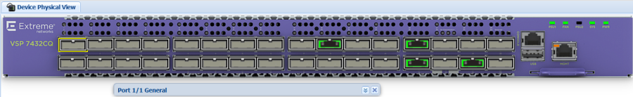

  6. To manipulate the tab, Select on the buttons in the top-right of the dialog box.
  7. Select the up arrowhead to minimize the tab as shown in the following figure.
  8. Select the down arrowhead to restore the tab to its original size.
  9. Select the pages to dock the tab back into the menu bar.
  10. Select the X to close the tab.
