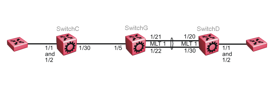

The following figure shows a sample greenfield deployment for SPBM.
Greenfield SPBM deployment
For migration purposes, SPBM can coexist with existing SMLT configurations.
The following sections show the steps required to configure the Ethernet and MLT interfaces in this example.
SwitchC
PORT CONFIGURATION - PHASE 1
interface GigabitEthernet 1/30
encapsulation dot1q
exit
SwitchG
interface GigabitEthernet 1/5
encapsulation dot1q
exit
MLT CONFIGURATION
mlt 1 enable
mlt 1 member 1/21-1/22
mlt 1 encapsulation dot1q
SwitchD
MLT CONFIGURATION
mlt 1 enable
mlt 1 member 1/20,1/30

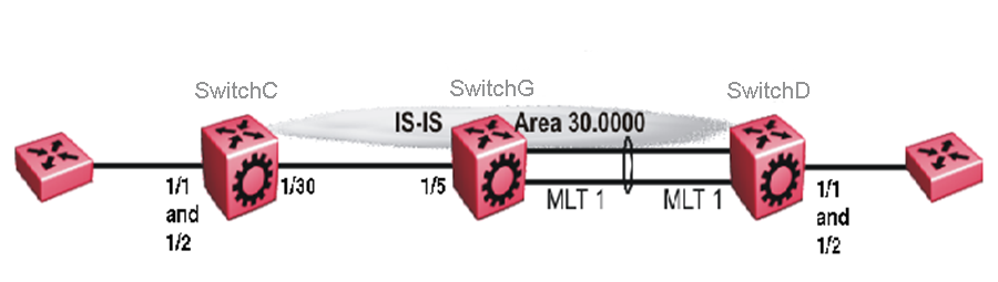

The following figure shows the IS-IS area information added to the network.
IS-IS SPBM global
The following sections show the steps required to configure the global IS-IS SPBM parameters in this example.
SwitchC
enable
configure terminal
prompt SwitchC
BOOT CONFIGURATION
spbm
spbm ethertype 0x8100
ISIS SPBM CONFIGURATION
router isis
spbm 1
spbm 1 nick-name f.30.13
spbm 1 b-vid 20
ISIS CONFIGURATION
is-type l1
manual-area 30.0000
sys-name SwitchC
exit
router isis enable
VLAN CONFIGURATION
vlan create 20 name "B-VLAN" type spbm-bvlan
SwitchG
enable
configure terminal
prompt SwitchG
BOOT CONFIGURATION
spbm
router isis
spbm 1
spbm 1 nick-name f.30.10
spbm 1 b-vid 20
ISIS CONFIGURATION
is-type l1
manual-area 30.0000
sys-name SwitchG
exit
router isis enable
VLAN CONFIGURATION
SwitchD
enable
configure terminal
prompt SwitchD
BOOT CONFIGURATION
spbm
router isis
spbm 1
spbm 1 nick-name f.30.14
spbm 1 b-vid 20
ISIS CONFIGURATION
is-type l1
manual-area 30.0000
sys-name SwitchD
exit
router isis enable
VLAN CONFIGURATION

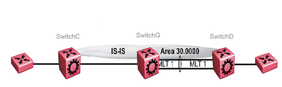

The following figure shows the IS-IS area information and interfaces in the network.
IS-IS SPBM interface
The following sections show the steps required to configure the IS-IS SPBM interfaces in this example.
SwitchC
PORT CONFIGURATION - PHASE II
isis
isis spbm 1
isis enable
exit
SwitchG
isis
isis spbm 1
isis enable
exit
MLT INTERFACE CONFIGURATION
interface mlt 1
isis
isis spbm 1
isis enable
exit
SwitchD
interface mlt 1
isis
isis spbm 1
isis enable
exit
