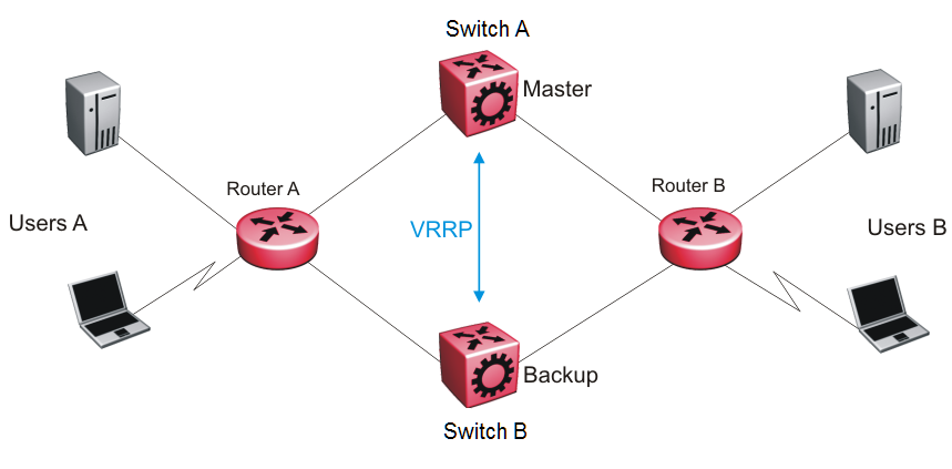

The following figure shows the minimum VRRP topology.
Traffic flows between users A and users B.
Router A uses VRRP global addresses as next hops for users B, and Router B for users A.
The VRRP master forwards the traffic and sends VRRP advertisements in the VLAN to announce to the backups that it is the master. If the master is no longer available, the backup takes over and becomes master. The only change occurs to the state of VRRP.
