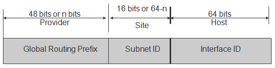

Global
A Unicast global address identifies a single interface and is similar to an IPv4 public address.
Unicast global addresses are globally routable in the same manner as IPv4 addresses.
The following figure illustrates the Unicast global address parts.
An IPv6 Unicast global address is composed of the following 3 levels:
  • public topology (48 bit Global Routing Prefix)
    • 001, specifies an IPv6 Unicast global address
    • Top Level Aggregation Identifier (TLA ID), the highest level in routing hierarchy
    • Res, reserved for future use
    • Next Level Aggregation Identifier (NLA ID), specifies a customer site
  • site topology (16 bit Subnet ID)
    • Site Level Aggregation Identifier (SLA ID); assigned within the site, an ISP cannot affect the SLA ID, enables up to 65,536 subnets within a site
  • interface ID (64 bits)
    • specifies the interface for a node on a subnet
The system uses the 48 bit global routing prefix for the route prefix exchange.
The IPv6 Prefix for Unicast global is 2000::/3 (RFC3513).

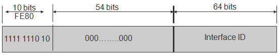

Link-local
Hosts on the same link/subnet use automatically configured IPv6 Unicast link-local addresses to communicate with each other.
Link-local addresses are automatically configured on all interfaces.
Routers do not forward packets containing a destination or source address with a link-local address.
IPv6 uses neighbor discovery (ND) for address resolution.
The IPv6 prefix for link-local Unicast addresses is FE80::/10 (RFC3513).
The following figure illustrates the parts of a Unicast Link-local address.
